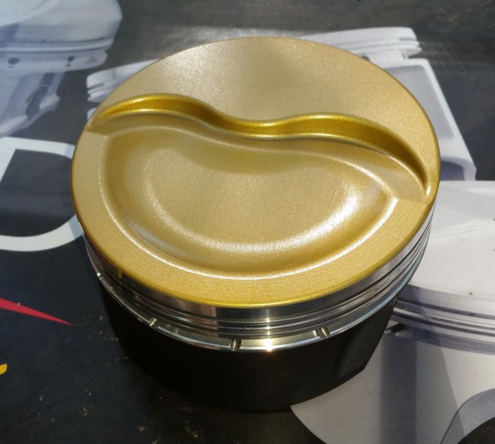

I have three 400 blocks, two of which are NOS. Diamond made me two sets of coated pistons, so I could retain the OE bore. I also wanted to keep the rod/stroke ratio at 1.65 or less.

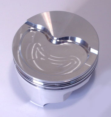

A picture of one of my pistons.
What I got was a pair of their 400>>470 kits.
3.915” stroke/6.535” length rods.
That gave me a 1.66 rod ratio – which is a tad more than I wanted.
My calculated (not yet measured) compression ratio is 9.486:1, using the Diamond pistons and aluminum stealth heads.
