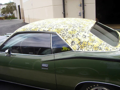

SonOfaTomP
Jul 22, 2017
346
123
Baltimore
i always wondered what it'd be like if someone did a Fifth Up like this
H_nQBuDIzR40Z3XT_7mhCj73D9un2VZ5vmuTdufejggy4dYKwk5OeDVU-Upn36DHyDzSUpErYbuLyv6fC5D7wrhzUUCY5U0w.jpg
1,430
577
Someone could always buy some stick on flower print shelf paper and find out. Could test it on a diplomat too:eek:
SouthBay
Dec 14, 2019
26
Austin
That's what I'm thinking. Not necessarily flower print, but something different like that.
