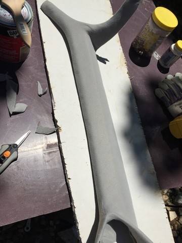

Trim:
1. Takes way more fabric to recover all the interior trim than you think. 10 to 12 yards unless you make a mistake and have to recover something.
2. Hardest trim part to recover is the a-pillars. I did the driver side 3 times before I got it right. Wasted easily 3/4 yard of fabric.
The A-pillar plastic piece has 4 'legs' and a long wide spine.
Getting all 4 inside curves without wrinkles and without cutting the excess fabric too short was difficult. Make sure you are as stress-free as possible before you start.
3. The key to getting the fabric on the a-pillar --- use the stretch of the fabric in your favor.
Glue the front of the spine first then pick one end and do it next. Audition the fabric several times and leave generous extra fabric to cover the legs.
My best analogy is pantyhose, but since few of you guys put on pantyhose.. think of this more like a condom. The material has plenty of stretch and you want to pull the fabric over each leg and have the tension of the fabric work with you to keep it pulled tight and held in place.
Put some contact cement on the top side of each leg, after you've auditioned the fabric and figured out where to cut a few slits for the curve. DO NOT CUT TENSION SLITS TOO DEEP. If you do, it will show when installed and you get to do it again.
Only put the glue on the plastic. Do not coat the back of the fabric. Wait. Wait. Let the glue get tacky. If you put the fabric on immediately IT WILL BLEED TO THE FRONT OF THE FABRIC... and you'll get to cut more fabric and do it again.
Lay the fabric on the top side of the pillar leg and stretch/ease the fabric over the edge of the leg. It will snug down and lay flat.
Glue your edges AFTER you get both legs covered.

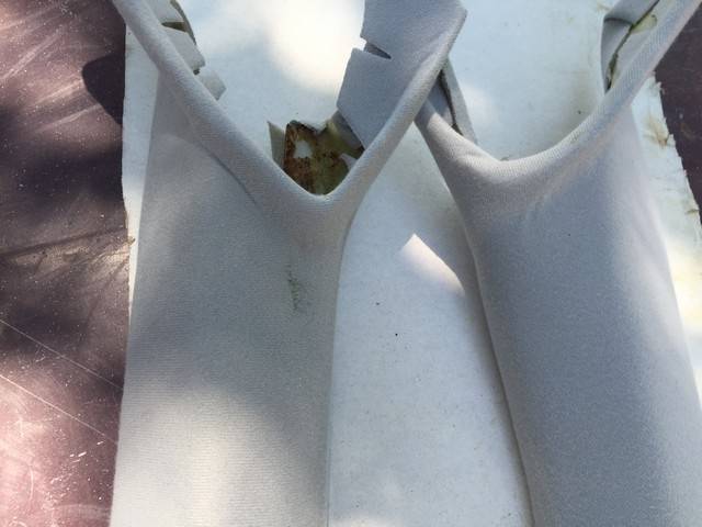

If you don't take time and audition your fabric, then ease the fabric onto problem areas, you will get wrinkles. Compare the left piece to the right piece.
Also notice how much extra fabric I have left and the slits to ease the tension. AFTER you have things glued, you can always cut more fabric away.
