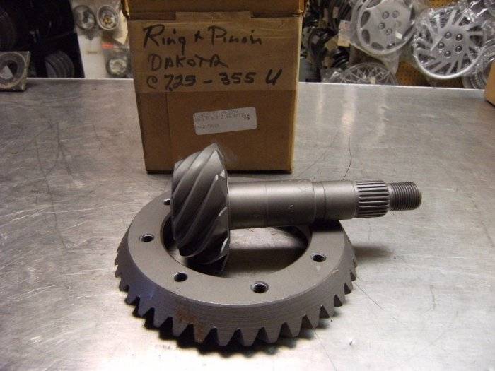

On the gear ratio change. Generally the hard part is obtaining the parts (which appears to be easier now than it was a few years ago). Giving parts to a differential shop and having them do it might not be a bad idea for you.
I have done quite a few differential repairs and ratio changes, so I have the tools and know how to do it.
A good technician can change the gear set out in about 3 hours. Most newbie’s would take about 5 or more hours to make the change.

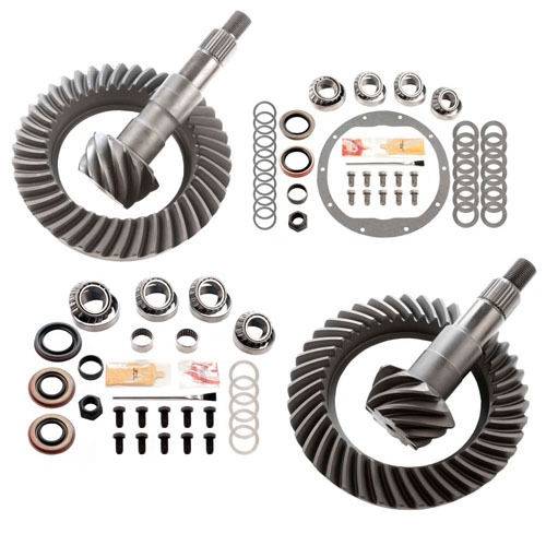

Parts needed is gear set, bearing kit (if any chance any fine metal is in oil, always change the bearings) and lube. Changing both rear wheel bearings is also highly recommended.
If current gear ratio is 2.7, then a 3.23 or 3.55 will fit fine. If you had a 2.2 or 2.4, then you would have problems with fitment.
One thing to consider is anytime a tire change is made or gear ratio is changed, the speedometer gear will also need to be changed to keep speedometer/odometer accurate.
