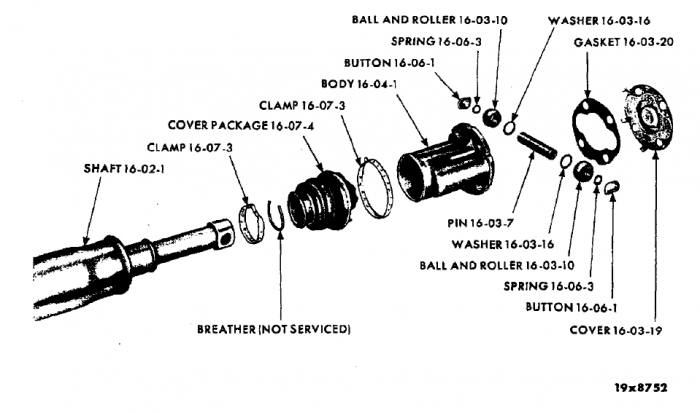

The transmission in the eBay ad uses a Trunnion for front propeller shaft – which bolts to a stationary transmission yoke.

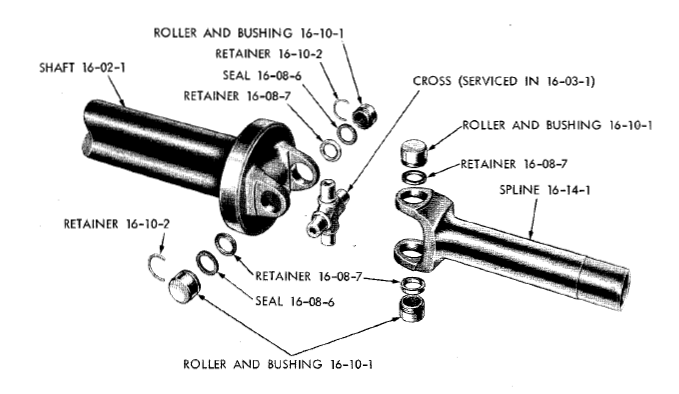

’66 and newer transmissions use a more conventional transmission slip yoke and universal joint. There is a very good reason why Chrysler got away from the trunnion joints (hard to work on, limited movement, hard to find, expensive, etc.) in favor by the far better design of the slip yoke design.
To modify your propeller shaft to a trunnion joint would be a "downgrade".
Parts are readily available to upgrade this transmission to use the ’66 and newer slip yokes, but those parts do increase the price of unit and transmission will need to be dissembled for output shaft to be replaced. Just look for A or F body output shaft and tailhousing.
