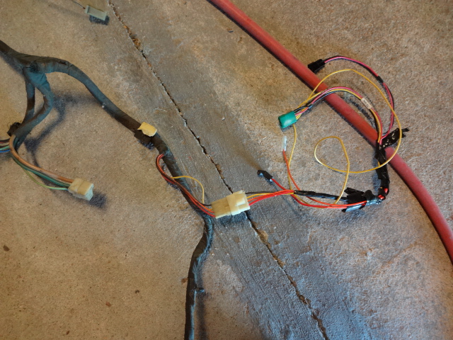

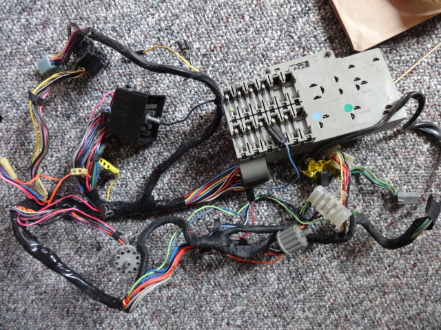

But the light harness that plugs into the main harness has the yellow lead going to what I thought was a ground, but its not it goes into the passenger door contact switch for like the dome light, maybe the trunk light. ect. Not shocking it goes from a small wire to a larger one.

Trunk light goes on the drivers side with the rear harness.Long orange wire goes to the console for the shift indicator light.
489
I knew that on the trunk light, it runs with the tail light harness in the upper rear quarter above the wheel well but what I dont understand is if all dont have the harness for the glove box light, ect... how does the opening the pass side door light the dome light, and if that harness isnt present on some how does the shifter light get lit?

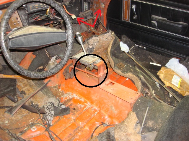

Yea, there is the orange wire in question, in the pic you can see the pig tail for the light package in one arrow and in the other is the plug for the dome light to go on, on this car I left the harness in the dash when I removed it.

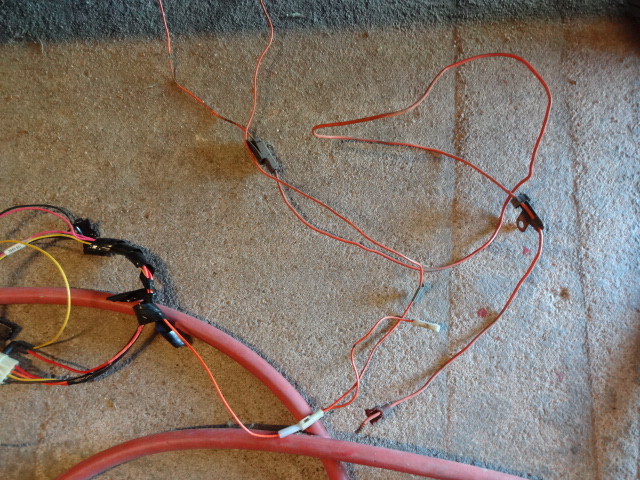

Dome light comes from the drivers side rear seat area to the roof,There is a harness for the door switch,that gets replaced with the light package harness,the console light is also a seperate harness,In your 2nd picture it has a splitter where it connects to the main harness.If there is no console the orange wire still has a plug.
489
Thats makes sense, I didnt go look but Id take the main harness has a few provisions for light power (the orange leads) because on the ones I have the orange splitter runs off the light harness. Fun Fun. My memory sucks on things I dont pay special attention to, thats why I take pics. Sucks getting older.

Brain fart here too,Orange wire is for the ash tray light,red is for the lighter.Glad I could clear that up for you.

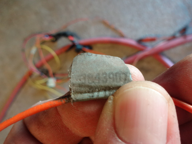

DC, I looked at that sticker, it was for a turn signal part. Not sure why its there and not sure why I never tore it off.
