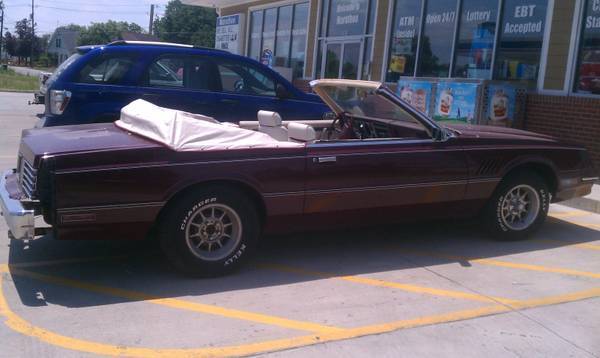

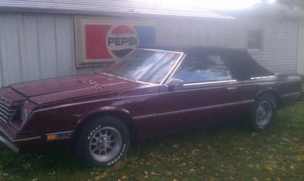

If this wasn't a bazillion miles away, I would definitely take a look. The roof cover looks bad though, really too tall and very "heavy" looking. I wonder what, if anything, was done to improve the structural rigidity of the car, seeing as the entire roof structure is gone, and our cars not having a full frame structure. If the roof cover/hump were reduced to a more reasonable size, I could see this as being a nice looking car. Colour on my computer monitor looks like a dark red/cherry/burgandy colour, which is most likely not factory standard. It is also missing its wheel center on the rear wheel.

There was a convertible here in NB, gold and excellent shape I don't recall how tall the top was when folded up, but it was a pretty good looking car. I do believe there was additional structure added to the under side to stiffen up the car. Even my t-top cars had additional structure added to the roof and a pillars.

With the new interior, tires, and wheels(?), looks like a great deal. Obviously needs some body work, no big deal. If it doesn't already have it done, tie the rails, add torque boxes, finish it up. For this price, I wish I'd found something like this before I bought my Mirada, honestly. Looks like a great project. Hope someone here gets it!

OK, fair enough. I just hope someone close to it checks this car out and finds out what it really is and how good/bad it really is, and saves it if it's worth saving. I agree with all the points here about the awkward looking top and such, but it could still be a good looking car with some work. Granted, based only on the few pics, and pics can always be deceiving (and usually are), but it looks like a good project to me overall, if it was a good conversion to begin with.
