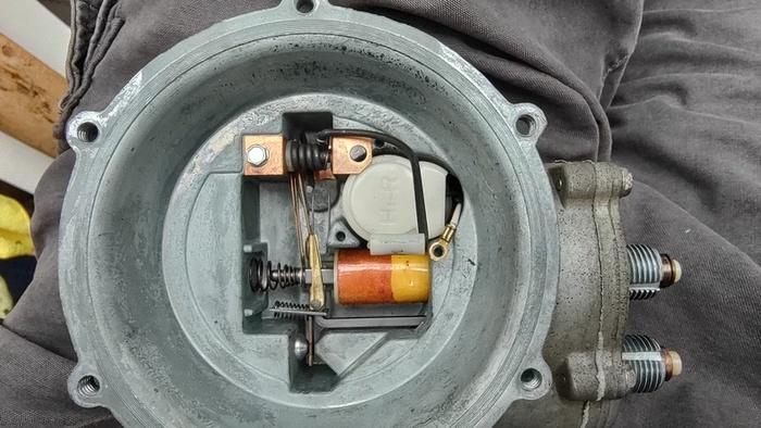

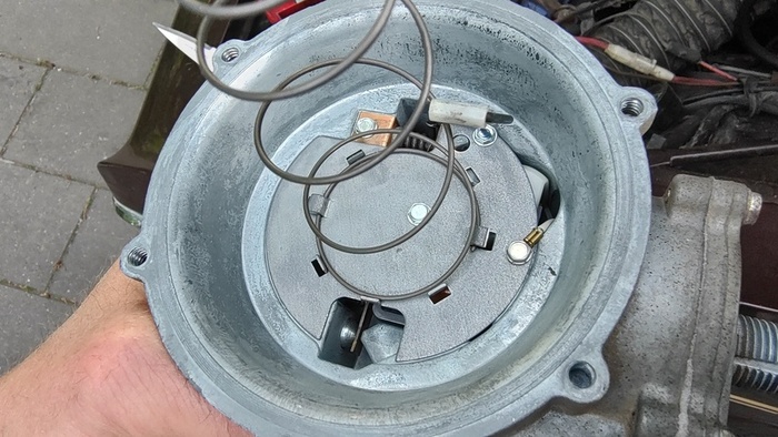

Then, I opened up the vacuum part of the thing. It was pristine inside (see pictures), except that the vacuum inlet "valve" (lower part on first and second picture; second pic has the center cover removed [three screws]) was slightly stained, as well as the conical inlet port. Cleaned that. Other than that, nothing to do - except that I actually found a small leak in the diaphragm (hard to see on the third picture). I put a drop of instant glue (Cyanoacrylate) on it and hope, that it'll hold. If the diaphragm is EPDM (likely), then chance are, that it will not hold very long. Further, risk of breaking at other areas exist, of course...

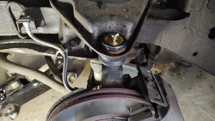

Meanwhile, a 7500mls oil+filter change and one of the upper ball joints replaced. I just *love* my impact drill. :) But, advise: do this whenever you have the brake hose disconnected - it is just completely in the way for this job. (But I hate to bleed the brake system even more and it is possible with the brake hose attached, but you have to be very, very careful if you'll use a (small) puller),
