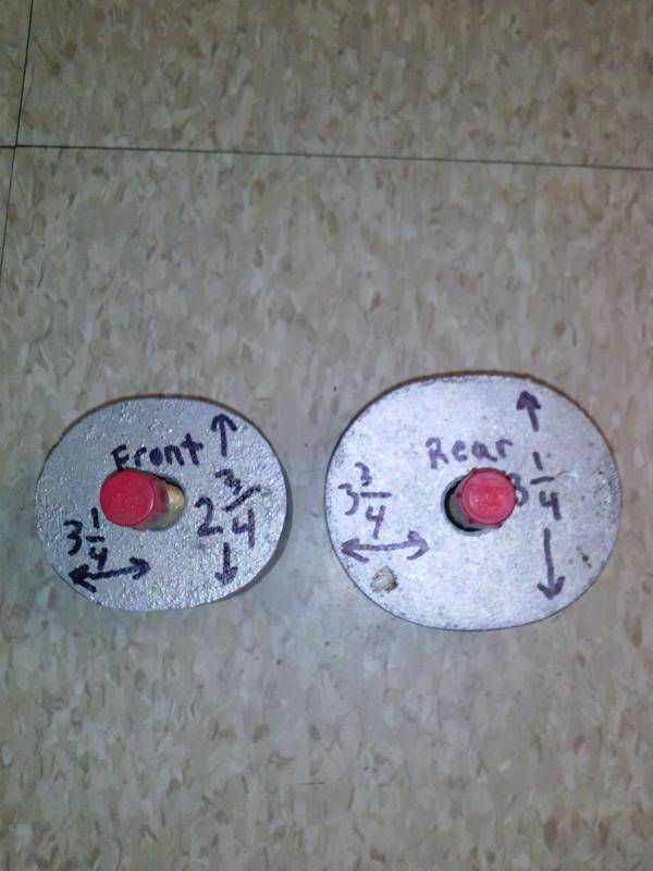

Shorty, they are oval. These dimensions are at the widest point.

The '73-up B-body/'79-'81 R-body isolators are the same, but they're reversed front-to-rear. No '72 B-bodies were built with the rubber-mounted K-frame. It was introduced for the '73 model year.

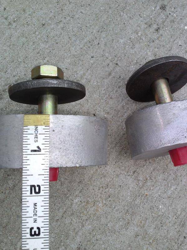

Another option is to use your original washers and steel tubing to make your own solid mounts. Accounting for the thickness of the washer, cut a section of 2.5" DOM tube the appropriate length and weld it all together. A smaller piece of pipe in the middle to keep the bolt centered is a good idea; only weld it on one end so you can drop the bigger pipe into place and weld it on both sides. Do not use exhaust tubing for this idea. It's too thin. The tubing should be at least the same thickness as the washers.
Solid mounts really firm up the car's chassis while making very little difference in ride quality. Plus, once you've mounted the K solidly, you can eliminate the steering shaft's rag joint for added engine-bay clearance.

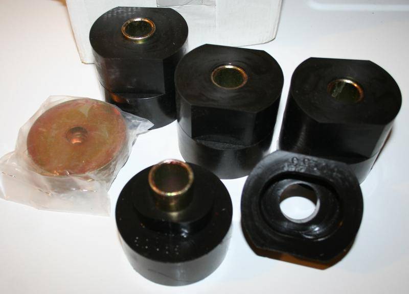

I just picked up the poly ones from ESPO for my Mirada. Look like nice pieces. Very hard, for me it was a great alternative to spending $225 for the Firm Feel ones. $83 shipped to me.

Well, all 4 are round, but 2 of them have cut off sides, so sort of oval. I told Laura at ESPO specifically the car they are for. Will these not work? I have to leave right now, but can get a picture of what I received later, tonight or tomorrow.

Strange... the B-body units are the exact same as R-bodies, and the FMJ parts should fit if switched front-to-rear. I positively know that's the case with the solid-aluminum parts as they're the same as the old Direct Connection/Mopar Performance kit except material (the MP kit was cast iron). The MP kit was listed for the FMJ cars, but the instruction sheet noted that for use in B & R-bodies, put the front ones out back & vise-versa. All three of the MP kits I had clearly had "FRONT" and "REAR" cast right into the parts.

Maybe this is immaterial, but I'm confused by the references to Energy Suspension. I got mine from ESPO (Springs n Things). Are theirs sourced from Energy? I did measure the poly ones I have and they seem to correspond to the measurements listed previously in this thread, so it seems to me they would work. Anyway, when I get home I'll get a pic of what I received.

My bad, I thought when you referred to ESPO you were referring to Energy Suspensions. From the sounds of it, we have the same thing. The footprint of the ones I have are slightly smaller than the oval factory ones, but with the extra hardness of the material, I'm assured these will work. Did yours come with new sleeves & washers? Mine are all the same size with (2) sides shaved into a double D shape (not cup size). The inside male & female slots are oval w/round holes for the sleeves.

Yep, sounds the same. I thought before at a glance that they were different, but all 4 of mine are the same. So in that case, there would be no "front to rear swap" issue, I assume?
