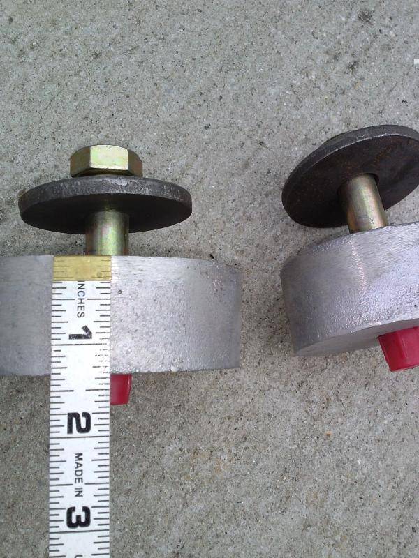

Firm Feel has cast aluminum K frame mounts, as you know. But you can make your own out of aluminum bar stock(6061,7075) some metal supply houses scrap the small pieces they can't sell. Maybe make your own.
I have a loose set somewhere, I think. My brother is a machinist, I'll ask about what it would take to make a set.
MiradaMegacab
1,847
753
Long Island NY
Firm Feel is 1 5/16 tall
My imp
Oct 14, 2012
1,102
32
Brunswick, Ohio
Under which car? The other measurements can be used from the old pieces, but installed thickness is different than un-installed.
My imp
Oct 14, 2012
1,102
32
Brunswick, Ohio
They list them for a '73 Charger, are they the same? My (early) '72 Charger didn't use them. They started in (late) '72. Both my '72's are early, so I'm SOL.
