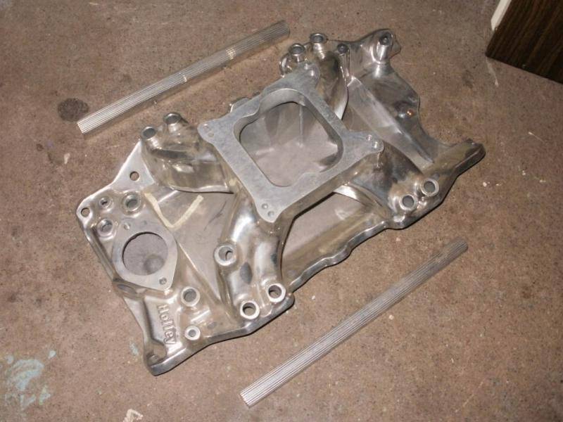

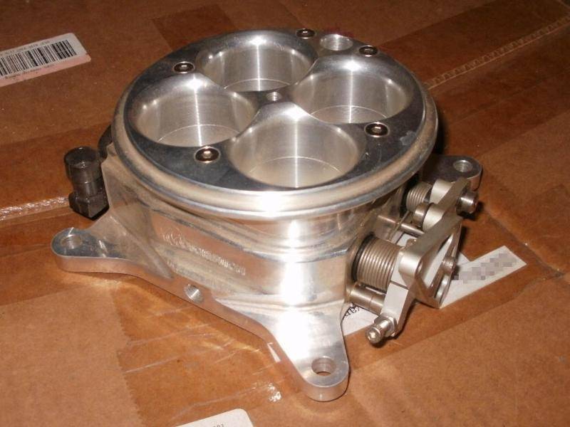

Modified brand-new Holley Strip Dominator intake, Motorvation 1100CFM throttle body, & custom fuel rails sitting atop Delphi 55lb/hr injectors (not pictured). Luxury, indeed!

Question, is this mounted on the original 318? This may be the way I have to go if I can't find a way to keep the original system running and get more power out of it. Or if the right car comes along and lack the original DFI.

I'm not really sure what engine I'm going to use it on for a final combo, but it's starting out on a 360. I'm also using distributorless ignition. There's still much to do, such as make some custom brackets for the coils & fuel rails, running lines, etc. I'm going to break the engine in with a ThermoQuad & distributor just to be safe, then inch my way into programming the EFI for the engine.

As the stock AC/ALT bracket will position the AC compressor right over the water outlet on this intake, what are you planning on doing instead (what year(s) small block bracketry/pulleys are you going with)?

Well, the intake is discontinued but was about $300 new (not polished). I didn't pay to have it modded, so I'd guess another $300-$500 there. The rails? I don't know, they came with the intake when I bought it, but they're billet rail stock custom-machined for the intake and may have been included in the conversion. The throttle body is around $700; the Delphi FJ10475 injectors are around $400 for the set if you shop around. PCM, wiring, etc. fall into the "how much do you want to spend?" category.

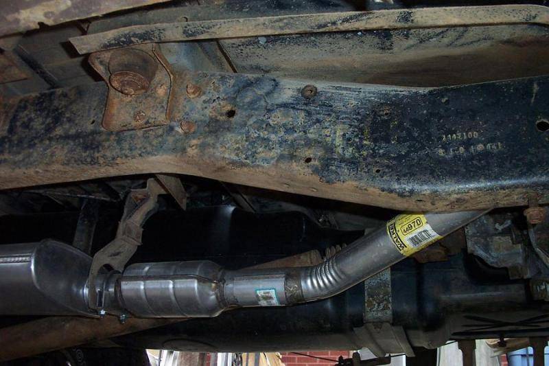

Well, while I was in Kentucky my B&M flexplate arrived to balance the 360 & bolt to the stock converter in the Imperial. Mixed feelings on that, since it'll only be in the car a matter of weeks and then I'll have no use for it anymore. My exhaust resonators landed today (AP #700196), which ought to be a real treat to squeeze into place out back since there's no room by the fuel tank as built. Still trying to determine whether I'm going to section the tank; Once the car's home I'll drop the tank for both this reason and to look into the fuel-pump fitment situation.
Ordered my pair of Innovate LC-2 wideband lambda (O2) controllers & sensors today, one for each bank, as well as my "Allflow" dummy catalytic converters. Those things are so simple they're brilliant: a catalytic converter case welded to the outside of a piece of straight pipe. Inexpensive, too: $40 for stainless steel, which is what I chose, and $35 for aluminized. We don't have emissions testing, which I suspect the car would breeze through anyhow with MPFI, but the local police like to look under cars & trucks to see if the converters are in place. I sold a number of them via the store I used to manage, and the gendarmes fall for 'em every time. :eusa_dance:
