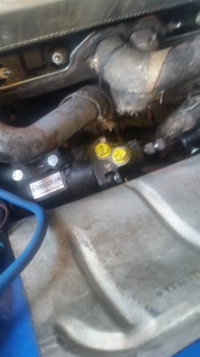

As mentioned though earlier in the thread, this won't eliminate the slop at 12 o' clock. The Borgeson box will. I installed one of these four years ago and couldn't be happier. Feels like rack and pinion. If you opt for this then order it through Bergman Autocraft and pick up his column adapter. Not cheap though at $800 for everything.
One last thing worth mentioning: the mount point on the K frame for the box is really weak. Below is a video of my box right after installing it. I only checked this because I just put the box in. It was probably doing this with the factory all along. Ended up forming a piece of flat stock to fit on the back side and welding it in place.

That is quite a bad flex you found there. I will have to check if mine does the same ! It´s probably not helping the slob either..
