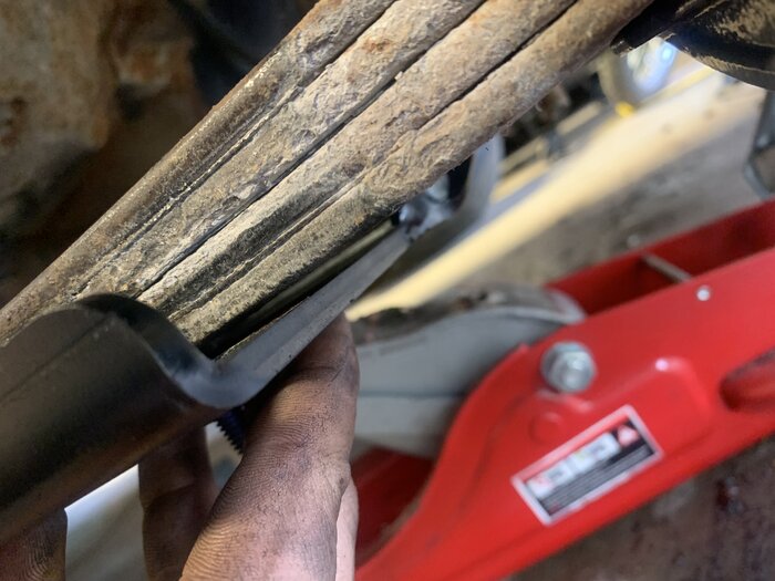

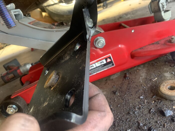

Ik the thread has been dead for awhile now but I’m currently in the process of doing this swap and am running Mancini b body shock plates and have a question about the locating pins.
reusing the fmj iso center pin “spacer”? Causes a gap underneath my shock plate that I can’t find any mention of anywhere.
My question is do I need to drill out my shock plate to center and pull up flush to the bottom of the leaf springs or is this gap supposed to be there?

I replaced the center pin when I did mine. I think I might have used an Allen bolt.
7,085
You'll need to enlarge the center hole or replace the center bolt like Duke did. The plate needs to be tight against the spring.
