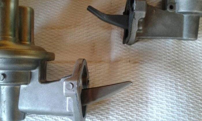

I went to Auto zone and told them the one they sold me I didn't think the lever was long enough. I also asked them why is it one year they have nothing for a 1977 and this year they do. I mean of course we all want original NOS parts when we are tinkering with our cars but finding those parts are not always possible so I am cool with after market parts if they work and are not crap.
I was sure to ask the manager why they are getting parts from manufacturers that don't work and of course he didn't say anything lol
Look at the picture unless I am blind they look nothing alike but was told it should work nope and they pulled that up for a 1977 Dodge aspen 2 door coupe 3.7 225.
The one Auto zone sold me is a Spectra and obviously doesn't work. I went across the street and had Advance go ahead and order me one from Car quest hopefully the design they have will work wont know till in the morning. I have looked at the lines I don't see any damage to them are clogs of any kind.

Top old pump bottom new pump

Well the fuel pump Advance had this morning was just like the original pump that went bad. The lever was correct and a exact match. The pump still is not getting any gas. I pulled it out again to see if the cam lobe was hitting the fuel pump as it is suppose to and there are marks on the fuel pump lever showing that the cam lobe is working like it is suppose to and not broke.
