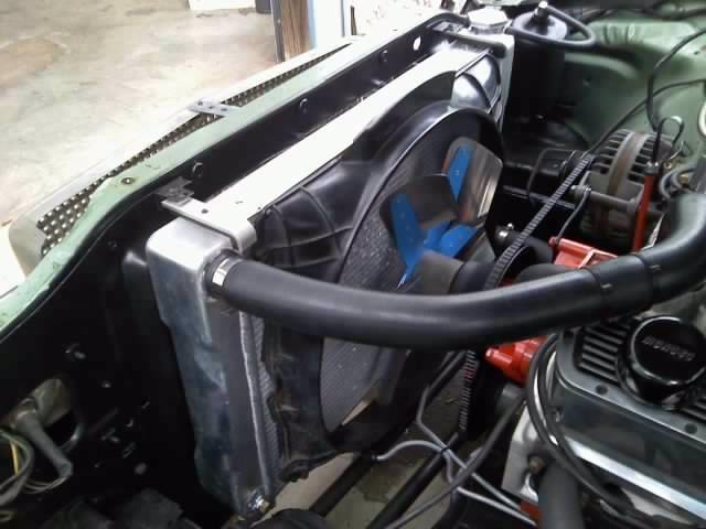

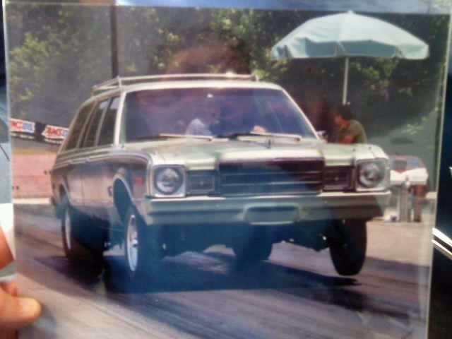

its a true street car and it has really good street manners. I swear it surprised me at how good it behaves when driving it in traffic. it never got above 180 degrees and it was 94 degrees outside today. the pic of the car launching was taken at the local dragway. it ran a 7.452 at 93 mph in the 1/8th mile with 3.73 gears. i was told the car was spinning when this happened but the old guy said no it hooked fine. as you can see, I think it did.

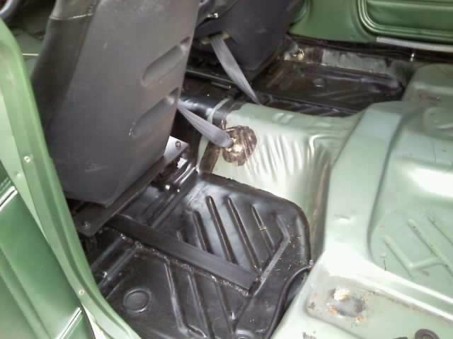

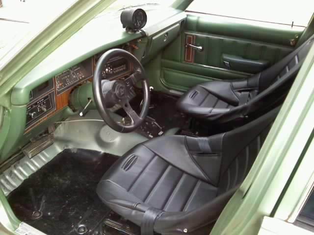

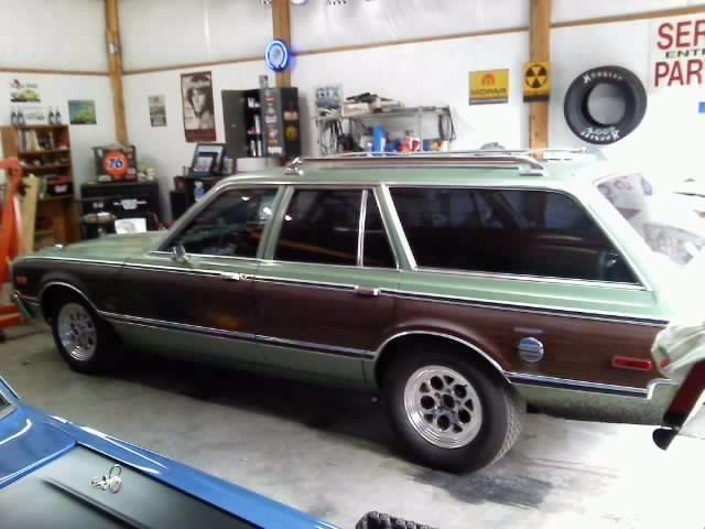

I wanna do a little dressing up on the interior. I like the race look but it needs some carpet. It came with a roll cage kit as well. I am going to have it installed since it has the pro street style door bars.

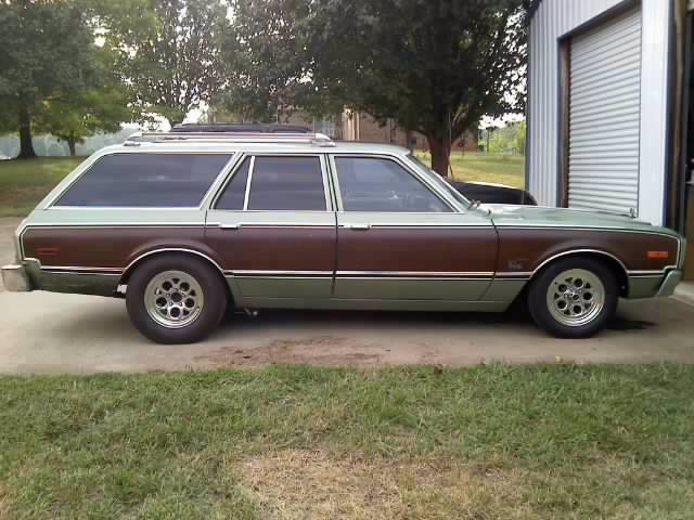

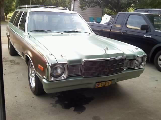

one thing that I really thought looked good was the front bumper. it is a 73-74 duster fiberglass bumper, and I can not believe how well it tucks into the body and looks factory. good info for guys wanting to "smooth up" the front end.

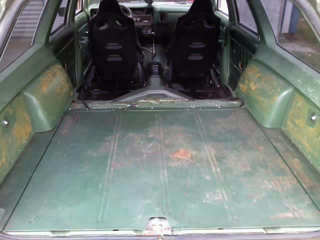

that's nice, but to bad the carpet n seats were ripped out
its cool the a-body fiberglass bumper fits, but its just too flat IMO

I have a another rear seat from a 78 aspen wagon available to me for free if I choose to go that route, and carpet is not a big deal. we have a fantastic upholstery guy in our car club here in town. that guy can freakin do anything and is fair with his pricing.
I'm thinking about just leaving the rear seat out and doing carpet all the way back after the cage install. its a street car for me first, because I have a race car already. however, I am still a racer, lol!

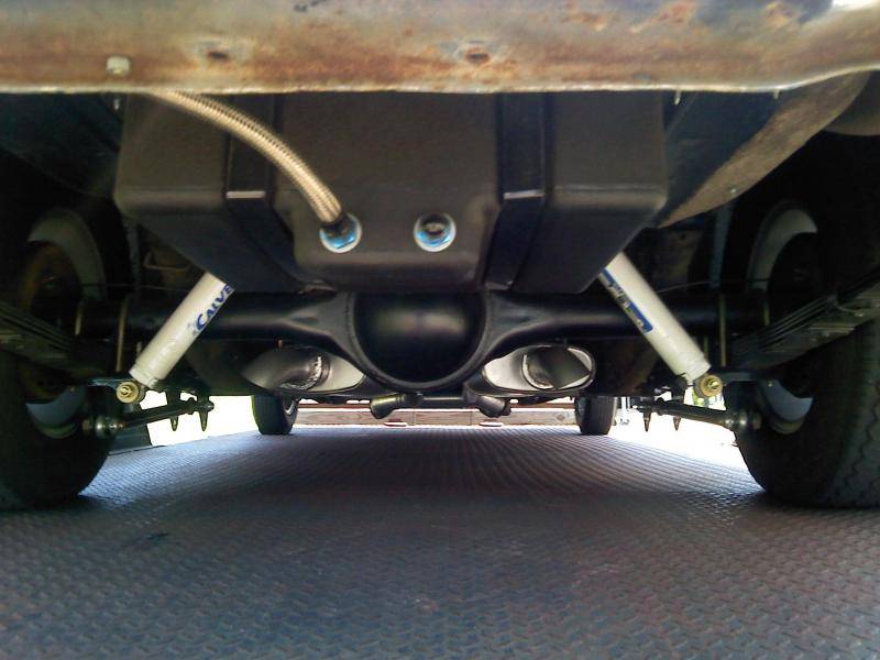

Also, are you running B-body rear suspension setup, or...? (I can't quite tell from that pic).
I agree about carpets, they would liven up that interior a lot, and it doesn't add much weight.

on the rear, it is a B body housing and standard B body leaf springs. it has off set shackles in the rear but they are not Mopar Performance I don't think. I have not looked at the front hangers but they should be offset as well. then it has Cal Tracs and Calvert 9 way adjustable shocks in the rear as well.

Wow, that's great. Thanks for being so thorough with the info. That helps me a lot, as it's sort of the performance I'll be shooting for with my Mirada after getting the basic systems worked out with a 318 in place while I build something bigger. Again, beautiful car. I love how it's so close to stock grocery-getter looking on the outside, makes it a really great sleeper.
