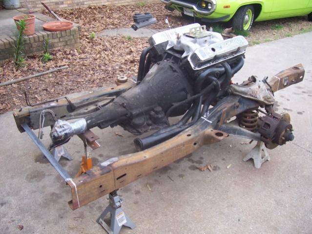

Not my pic.... I found it on the net. Dak frame with a big block.... I get ideas.....

I like the idea of using as much of the dakota frame as possible, trimming it to fit all the way back to the rear subframe.....
Thanks for posting this....

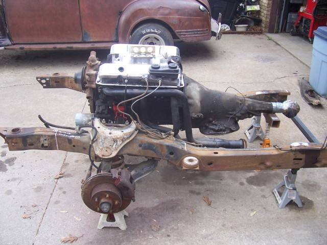

hmmm, interesting. dunno why i never thought of this as i have a 87 dak frame and a 87 5th ave. but the dak frame is being used for my 47 dodge truck. the frame would benifit me more for my application, as i put my car under a LOT of stress (see pics below), though i do have frame connectors and the solid k-frame mounts with the shock towers welded to the frame rails, i would rather have a full frame, plus the coil front suspension would make it a lot eaiser to work with

I copied from service manuals the needed pics, had to resize them to make all have the same wheelbase on paper. They didn't use the same scale on the Dak drawings as the FMJ drawings.
The Dak frame is a bit short ahead of the front tires, a good thing if you are dropping an FMJ on a Dak frame. The Dak frame has a different rise where the rear seats would be, means not having a thick cushioned comfy rear seat bottom. And of course the trunk area would have to be cut out and made to fit the rear of the Dak frame. It would probablly be easier to keep the rear frame of the FMJ and splice it to the Dak frame.
I think the biggest issue is the height of the engine as it sits on the frame. Looks like the Dak engine sits quite a bit higher....certainly the tranny hump does....I suspect a dakota hump would have to be put into the FMJ but then the drive shaft will be at a steeper angle.
