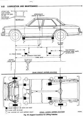

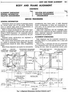

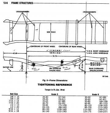

I copied from service manuals the needed pics, had to resize them to make all have the same wheelbase on paper. They didn't use the same scale on the Dak drawings as the FMJ drawings.
The Dak frame is a bit short ahead of the front tires, a good thing if you are dropping an FMJ on a Dak frame. The Dak frame has a different rise where the rear seats would be, means not having a thick cushioned comfy rear seat bottom. And of course the trunk area would have to be cut out and made to fit the rear of the Dak frame. It would probablly be easier to keep the rear frame of the FMJ and splice it to the Dak frame.
I think the biggest issue is the height of the engine as it sits on the frame. Looks like the Dak engine sits quite a bit higher....certainly the tranny hump does....I suspect a dakota hump would have to be put into the FMJ but then the drive shaft will be at a steeper angle.
trying again, looks like the daktoa has more front frame than the FMJ, would have to be trimmed....
Dak engine sits a bit forward compared to FMJ, maybe the tranny hump won't be an issue after all.
we need someone with a gen1 dak and a 4 door FMJ to park them side by side and do some measuring.
Some of the FSM drawings are not very good...

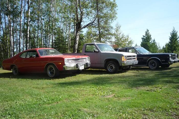

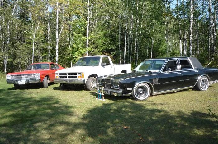

these are the only pics i have of my gen 1 dak and 87 5th (before i parted out the dak for the frame), but it looks like the front frame horns on the dak frame would be too short, which would be fine cuz you could keep the front horns on the M-body for the bumper mounting brackets.
btw, all 3 have 14" wheels

WB of daks is 111.94", WB of FMJ 4 door and M 2 door (ex. 80 and 81) is 112.7"
Track is the same as advertised but Dak wheels have deeper backspace so Dak axles are a few inches wider.

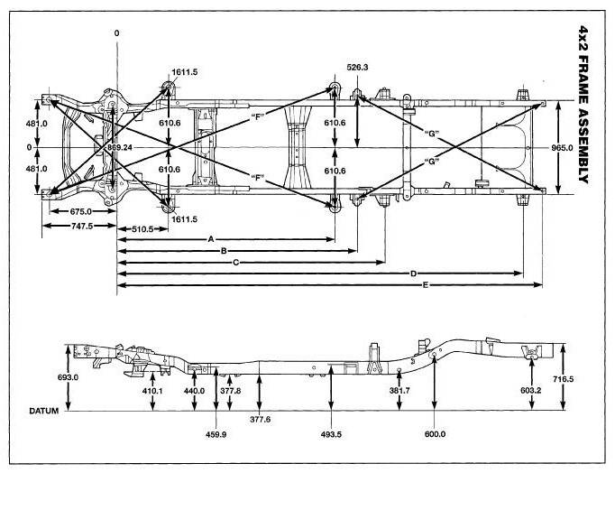

2004 is the last year for the 112" wheelbase, std cab and short bed....availble in Gen I or II...
In 2005 Dodge quit making the standard cab, and the Dakota went to only one wheelbase that covers the extended cab with 6.5' bed, and the quad cab with 5.25' bed. The 2005 is also several inches wider, the drawing Gred posted looks newer than 2004....

I don't have frame rail specs but I suspect GenI and II will be the same, altho the Gen II axles are a bit wider. If the frame is wider for Gen II, you would have some options to consider....
