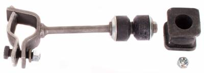

While browsing about, ran across the sway bar center links (complete assy) at PST if anyone is in need. Says they're for the 7/8" sway bar though, which makes no sense unless I'm missing something. Thought there was only 1" and 1 1/8" (and possibly 15/16"). The parts manual only lists 2 different links, standard and H.D. At any rate, they have these.

Is that the right one? The distance from the bracket to the bushing seems really long.
The later B/R-body links and C-body links look similar to, but are different from FMJ. I doubt they will interchange (I hadn't tried, so not sure - but FMJ's do look shorter).

You guys could be correct. I selected 1979 Dodge Aspen as the filter, and it says that it fits but, maybe their listing is wrong? Might explain the 7/8" bar thing. When I got my front end rebuild kit from them, many moons ago, it came with sway bar links about 6" long (which I think were for a B-body or something), not even close for an F/M/J body. Everything else in the kit was correct though.

It could be they don't know.
If someone was in a bind you could probably take their bracket and modify it to work. That's what I'd be trying.
