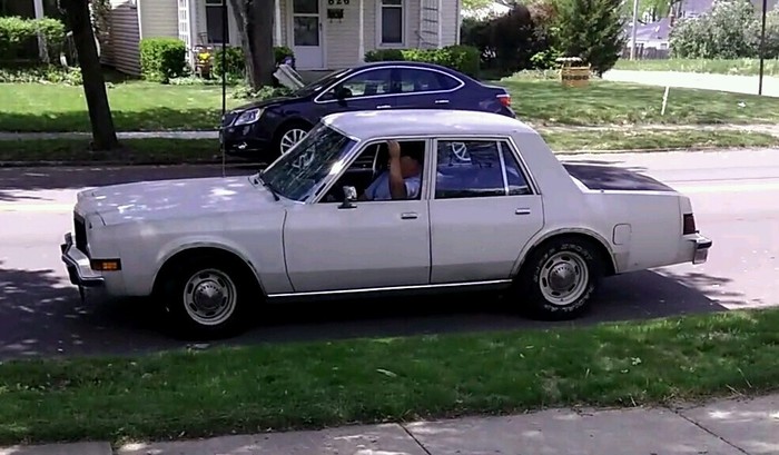

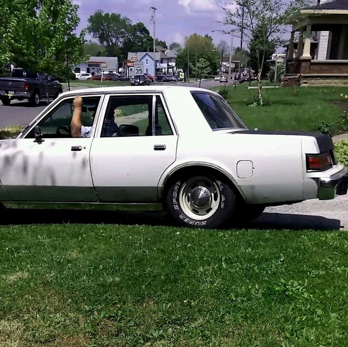

Screwed with it some more Saturday. Dad drove it a bit, but still needs a couple things here and there.
Thought this was a cool picture within the video I took of him backing into the garage.
Here's a whole shot of the car..dirt and all.
