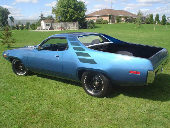

Enjoy ,,,,,,,, Hewre's the link also ; '69 Charger R/T - jakesgeneralstore.com
2,991
I admit to checking dimensions of an f-body and last style ElCamino once and, it's pretty darn close. The rear window and panel, along with the back part of the "cab", and also the trim along the top of the box, and up around the back of the roof, even bed inner panels. Putting Chevy parts on a Mopar is kind of cringe worthy but, you use what works I guess. Wagon modified for coupe doors, merged with brand X parts. If done well, it could look nice. If there was a way to get door glass that was angled on the back instead of straight up, all the better. That would be pretty much impossible though, or at the very least, cost prohibitive.

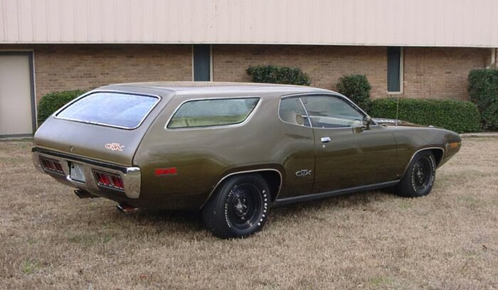

2,991
Is that a real build or a photo shop? This is the best looking wagon EVER!
I did a little digging and, turns out it probably is photo shop. Darn good photo shop though! There's others the same guy did, like a '71 GTX "Ute".
