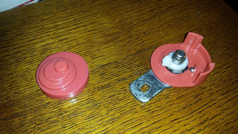

ive just got 1 of these ebay kits. came with no instructions.
has anyone used them before ?

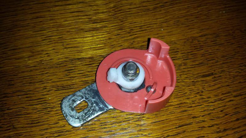

ive attached the new pink part with the hole in, but cant figure out how to put the other pink part on or where it goes !
not sure if the white piece goes there but it fit.....
showed it to several people/ mechanic buddies and none of us can figure it out.
thanks in advance for any advice on how to install this

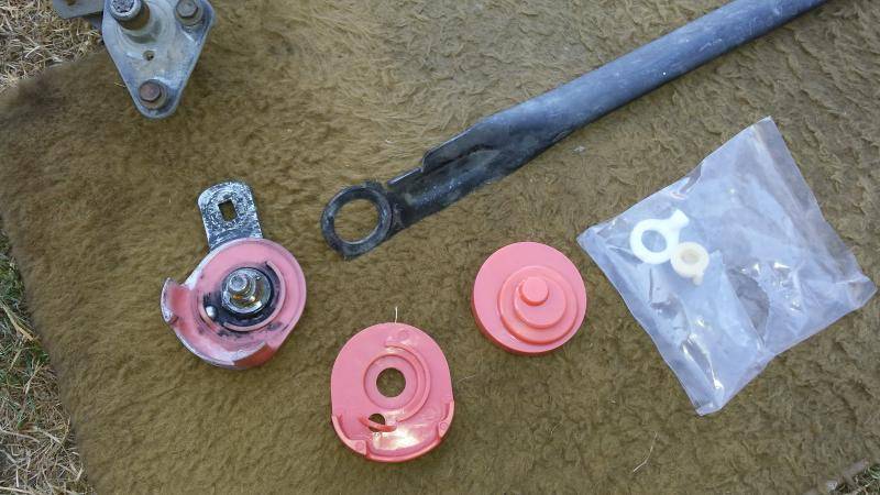

I will post a pic of factory wiper linkage later.

If you can't figure it out, I happen to know that he seller will be happy to assemble it for you... I wish he'd post that in his advertisement. It may be worth it to send it to him as it is very difficult to snap the pieces together without wrecking them. (Ask me how I know!)

Marko, looks like u have to take the white plastic thing off. Lube, and press the pink thing on. Then press the wiper linkage bar onto the concentric circles. Use plenty of lube, lol. The white plastic thing appears to attatch the wiper bar linkage to the pivot.

Hi, thanks for your purchase. You must not have received the instructions that are usually taped to the kit. I have included those as follows :It is pretty easy to assemble. You will need to remove the whole wiper transmission from the car. Remove the spring from the crank arm, replace pieces below that and reinstall spring. Snap cam piece over the shaft on the crank arm. use White lithium grease as a lubricant. Install that assembly into arm of wiper transmission using a large socket for a spacer to push against and a c clamp or vise to press it together. Once all is snapped together you are ready to reinstall complete assembly. Thanks again for your purchase! It does take some pressure to install, but they are sturdy pieces not like the original brittle pieces. If you are still having problems, please email me at mindy at murraybpark dot com.
