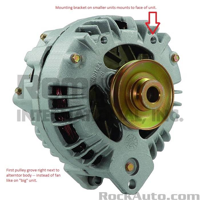

Hey guys: My Cordoba is sort of a rolling hobby for me -- I've upgraded the stereo, it has a sub mounted under the seat, I have a CB radio and HAM radio installed. None of these items are big current drawers, but they add up. While idling, lights on, A/C running, and my gadgets on, the discharge LED in the cluster glows. My voltage drops to a dangerously low 10 volts. Revving the engine and/or shutting off the headlights brings the voltage back up. My regulator is fine, and the alternator is fine -- I'm just drawing enough current to overtax the alternator at idle.
Question: Can I simply swap in a high-current alternator for a V-8 application? When I look at pictures of that particular alternator, with the external fan out front, it looks like the pulley isn't in the same plane, but I can't tell for sure.

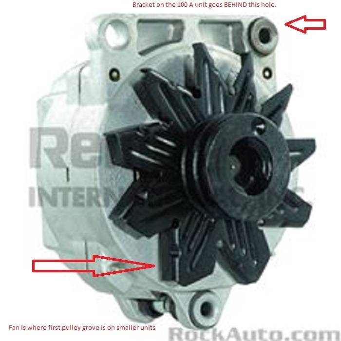

Would the big case 100A chrysler factory alternator not have worked? There seem to be a lot of them around, but I have only seen them on the V8s. I don't know what the brackets/pulley set up is on a /6.
kkritsilas
Jun 21, 2012
2,009
450
Calgary, Alberta, Canada
That IS a huge alternator. I understand that it is an older design, but it is big, and it weighs a lot. On the other hand, I guess they didn't spare the copper or magnets on those things. The ones that I have are all double belt pulleys; probably needed to keep the thing spinning.
Nope, it won't work without fabricating brackets. The cooling fan is on the outside of the body of the alternator. On the 100A units, the mounting bracket goes behind a mounting tab... On the smaller capacity units, the bracket mounts to the front of the body.
