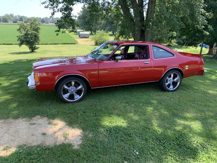

I really like these wheelvintiques police wheels because they are 15x10 instead of the stock 15x7 so a wider wheel would fit nice. I just don't know how wide I could go on M body.15x10 Chrysler Police Black 5x4.5" bolt 5.5" backspace
I remember seeing an 88 or 89 Diplomat with 18" Dodge Charger Police wheels on it! Car was for sale and I don't know what size tires it had but it looked good! Don't know how he fit them and wondered if they rubbed.
