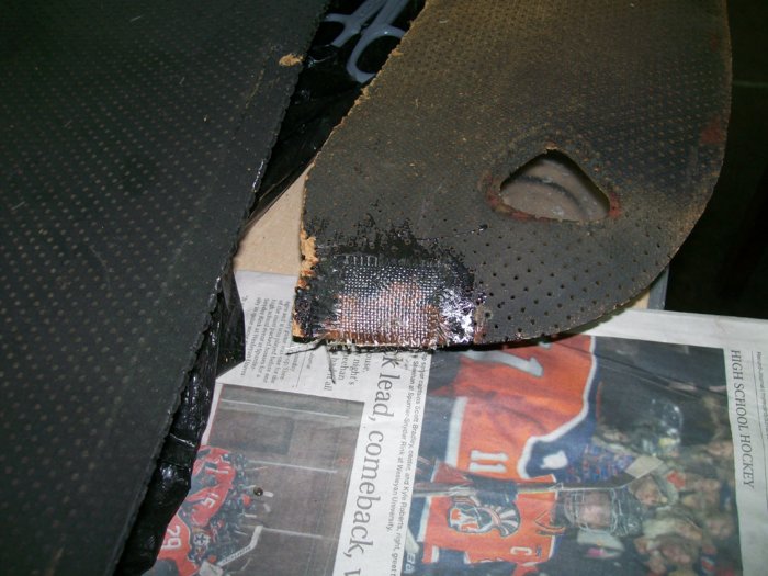

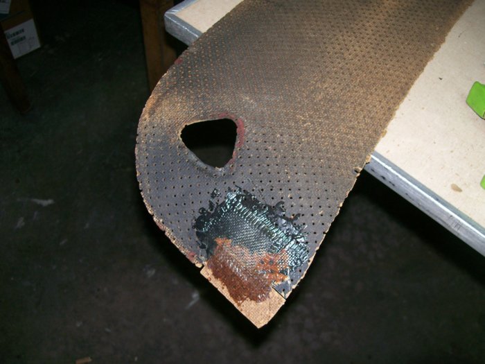

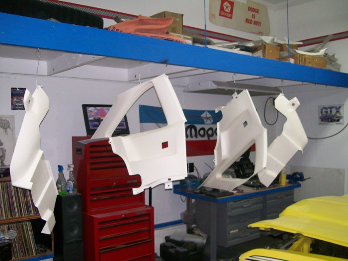

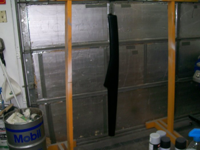

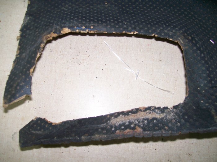

Update:Headliner repair,1st photo is the swollen cardboard headliner from the mice that lived in this car.Repairs made to the headliner

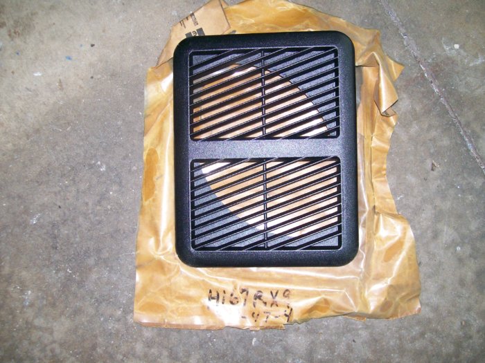

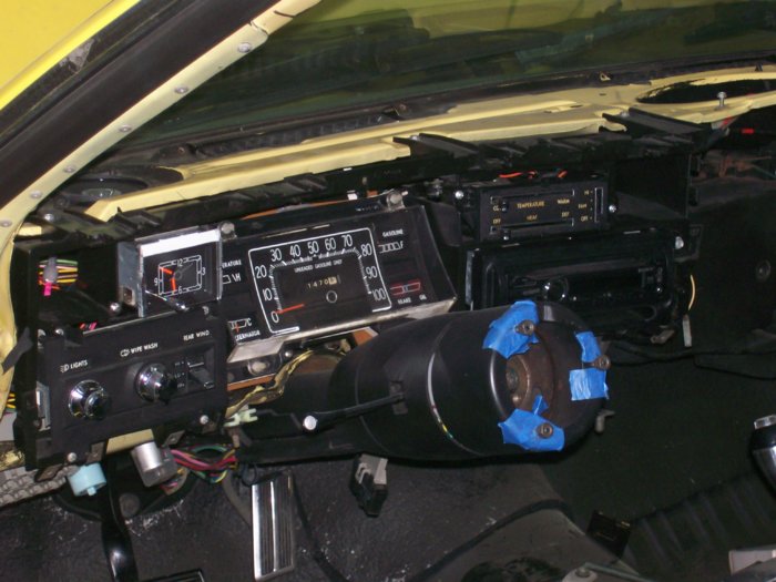

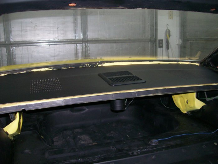

NOS rear defogger cover,package tray installed,NOS clock,stereo,heater controls,installed

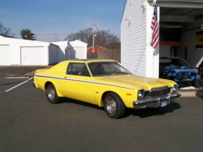

Hey Chris,looks like something is missing in the front
Excellent work!

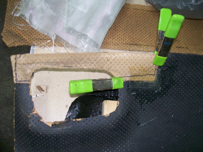

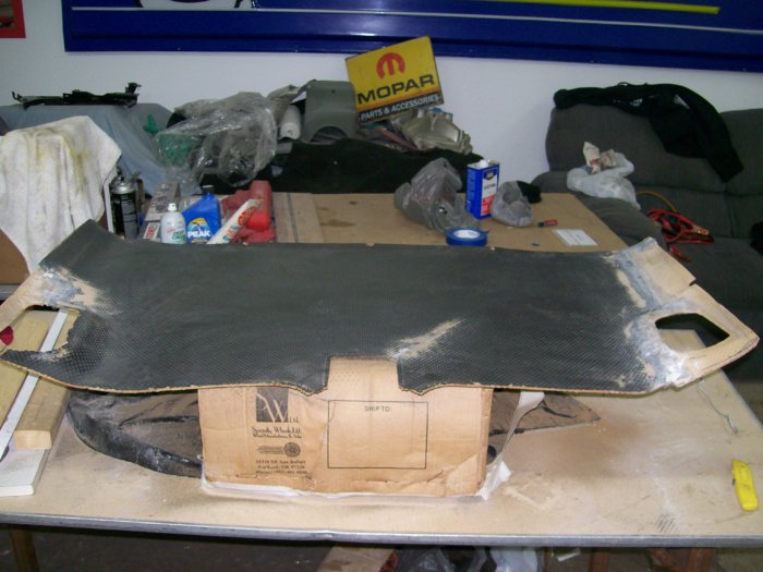

I see the pictures (post #’s 21 and 22) but can you describe, in more detail, what you did to your old headliner, please?
Also what you did to finish it (ie: paint, dye, sealant, or whatever), please?
Bud,I cut out the piss swelled pieces and was able to get some junkyard replacements out of a 80 Aspen.I used fiberglass to join the pieces,easy fix just time consuming as its only thin cardboard material.I had to reshape it 1st by soaking it with water and weighing it down.After I test fit it I plan on sealing it with paint and will cloth cover it to hide the repairs.I'm installing a SE/Deluxe interior with rear armrests.Cloth headliner is part of that package.I'll post the pictures as I do it but our heater in our shop sh*t the bed.I really begining to hate Winter up here more and more.
