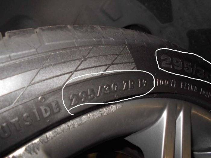

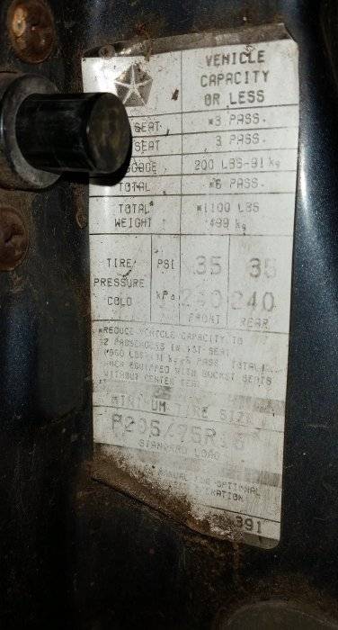

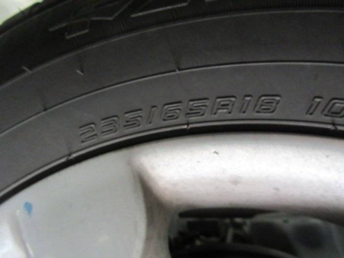

Tire size will make a difference.
Wheel size, not so much.
If you look at the tires, there should be a tire size stamped on both sides and it will look something like this
On your door jamb, there will be a tire sticker that should look something like this (might be in owner’s manual, as well).
Hard to read but says P205/75R15 (from my ’86 5th Ave), which is metric.
The tire size on my ’77 Volare Wagon are F78-14 (with FR78-14 and GR78-14’s optional).
All three tire sizes do not have a metric equivalent.
Can you record the tire sizes (and make sure they are the same on all 4 corners) and report back, please?
