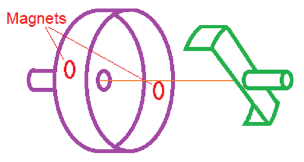

Mechanical speedometers are odd on how they work (at first). There is a non-scientific method to adjust them (it is more like lots of trial and error).
On one end you have a loop with two magnets on it. On the other end you have a “C” shaped piece of metal that goes inside of the loop. As the loop spins, magnetic force of magnets causes the steel “C” to move. Keep in mind the “C” has a spring on it to keep it from spinning.
The way to adjust the speedometer is to increase (or decrease) the distance the “C” fingers are from magnets in very small adjustments and/or adjust the spring tension.
There are two bushings, one for each shaft. If those bushings wear (ie: high mileage cars), the rotating end will rotate off center – which will make the “C” finger closer to magnets - the point the needle will jump all over the place – which is currently occurring on my wagon.
Speedometer shops have an electric motor that can operate at three speeds. I think 30, 60 and 100 MPH. They connect a "known speed" to speedometer head and keep adjusting until all three speeds read at 0.1% for certification or 1% (or so) for everyone else.
I have no question that certified speedometers are correct. My question is how good the officer’s eyes are at the time (which can be conflicting to comment about when you are the recipient of the ticket).
