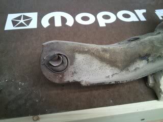

So I started digging around the front end and heres what I found
Lower control arm bushing so far gone it wore into the control arm! All the other bushing were trash too, even had to replace 2 upper control arms due to wear.

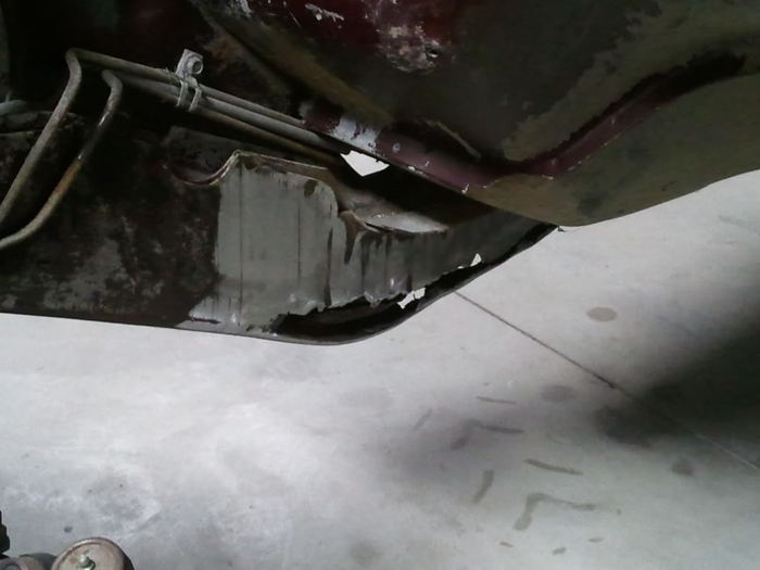

Well I rebuilt the whole front end and started driving it again ....Next up timing chain took a dump...Ok the motor was acting tired so a buddy had another 360. I pulled the motor and look what I didn't see while doing the front end. (Its cleaned up for the pic)

That is a nice air conditioned frame rail.

Ok, honestly I don't remember if I was told the frame rail had been capped, I seriously doubt that would have changed my mind about buying it. But just FYI, the side that was capped looks great, this pic is of the other side after I ground off the flaking rust that was covered with I assume POR-15.

I have to say that there's some prevously fixed quarter rust very evident in one pic.
Is it 1/2" wide or 4 1/2" wide?
Hard to tell from just a pic, but you can definately see its rusted, fixed, and rusted again.
Is that the only spot? Possible but not likely.
