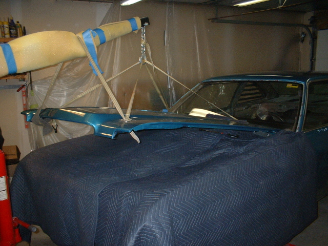

Removing an FMJ hood solo might be an impossible job - unless you have some kind of a crane, rope (from a tree) or something. Otherwise, all one will do is damage a lot of things (including yourself).
Even with two people - it is still a challenge (more so with install).
Then moving the hood by one self - also challenging.
Don't forget to add some wind to the mix...

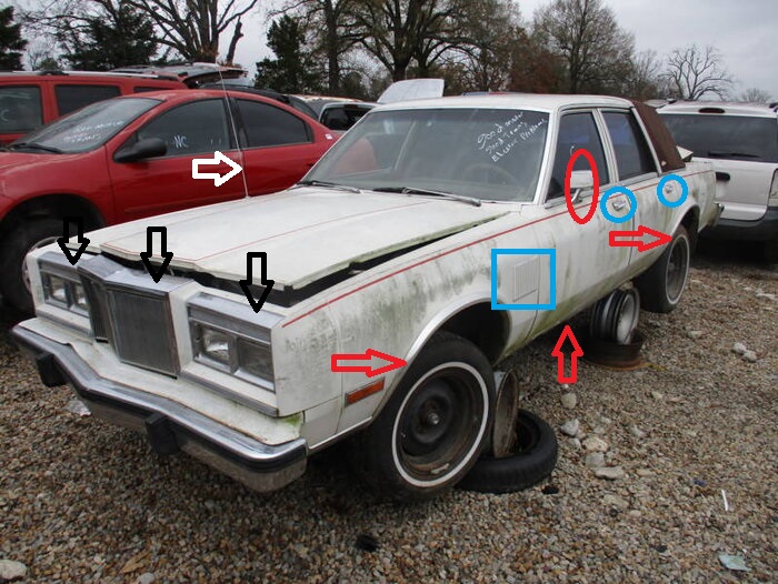

I'll be going back over there on Wednesday or if that doesn't work out, I'll head back over this weekend for a few more bits and pieces.
I was wondering if you think I should pull anything else, like bumper fillers or headliner-backer -- some of the chrome bits or window shades?

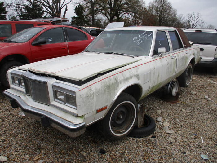

From what I can see from this picture - and all of this is strictly optional.
Black arrows
Headlight doors and grill frame. Check chrome for pitting. I found a Fifth Ave with wonderful looking chrome and grabbed it a few years back. These three chrome pieces on my '86 Fifth are full of pits (which is very hard for a chrome shop to fix).
The grill frame looks damaged on this car - as well as the bumper filler(s) - possibly.
White arrow
Antenna - if car has a manual antenna, grab it. This works good as a power antenna to manual antenna changeover (for you or someone else). Power antennas are nice when they work but not so nice when they don't.
I had converted my '86 Fifth Ave to manual antenna (and gave you the old motor).
Blue box
Not sure what to call this but "gills" maybe. These get torn off via car washes. If you got time, I would like to get a pair, but don't go out of your way. The black inner fender usually has to be removed to gain access. They might have large nuts on outside, clips or even held on via double-stick tape. The Fifth Ave "gills" are speicific to M-body (Fifth Ave) only, I believe. They are different from Left to Right and there are minor differences over the years.
Blue arrows
Door handles (inner and outer's). These break from time to time - so nice to have a spare. They make two different outer versions: one with recess for paint (or a sticker) and those without a recess. The ones on this car should be recessed with a (white) decal on them. Left and Rights are the same - but the plastic clip (to rod) is different from Left to Right.
Red arrows
Wheel well trim - ALWAYS grab these, on any FMJ, when one in decent shape one is found. Always mark (on back side - so it can't be seen when installed) what position on car, the trim came from, for all 4 wheel wheel trim are different (as well as 2-door rear is different from 4-door rear).
Body sill trim - if not beat up. The plastic clips that hold this trim on can be hard to find, so if removing the sill trim, grab the clips, as well. To remove the trim - push up on the metal part - about 1/8 to 1/4" then pull out on bottom edge (if I remember correctly).
Red oval
If side mirror chrome is not pitted and if glass is not scratched up, it might be worth saving the side mirrors. The important part is not to kink the cables!
Inside car
ashtray - if it hasn't been used.
Cigar lighters if in decent shape. The heating element can be replaced if in bad condition (with old knob).
Trim or bezels that are in decent shape.
Headliner - if in decent shape (the backing or board, not the cloth overlay).
Rear of car
Tail lights maybe (if decent)
The rear bumper fillers (if decent)

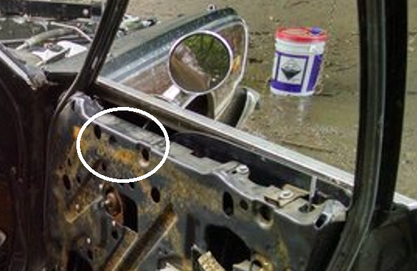

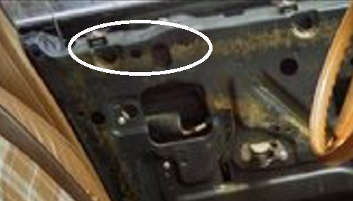

If the driver side door window is in the up position, how do I get it down to get access to the trim
The door glass needs to be in either a full up position, or completely removed, to access the three 3/8 inch mirror nuts. Use a 1/4-inch drive 6-inch extension with a 3/8-inch deep socket into three holes on inner door frame:

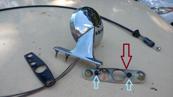

When you get the mirrors removed, there will be a bracket (red arrow) on inside of the door:
Which is held on by two plastic clips (blue arrow). A flat blade screwdriver (or something) will pop those clips off.

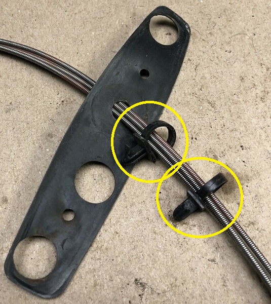

The most IMPORTANT step is to NOT PULL on the CABLES at these clips (yellow circles):
You WILL (not if or maybe), I repeat, you WILL kink the cables rendering the mirror useless (for mirror will always go back to the kink which is never where you want the mirror pointed at).
Just cut the clips. A person can find something to attach cables to the door frame (another clip, or zip-tie, or something). Those black plastic clips are almost impossible to remove intact to begin with.
When I worked at a dealership, and car was needing the mirror replaced, I would take diagonal wire cutters and clip/cut on the circle. I would then gently pull the cables out of the "cut" ring then (gently) push the cables back into the original clip leaving the new clips still attached to new mirror.
