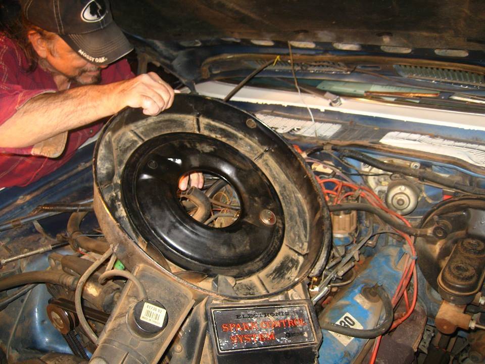

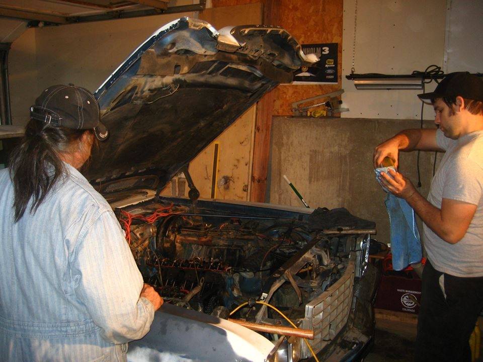

Adding a couple pics from the cop car when we refreshed the valvtrain a couple years ago, and converted from leanburn (still have all the old parts).

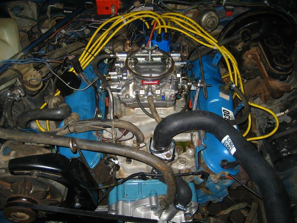

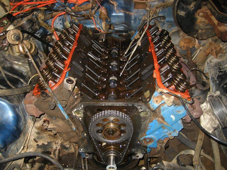

Here are the only other pics I've got from when we refreshed the valvtrain.
