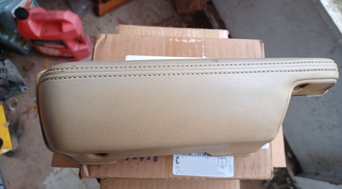

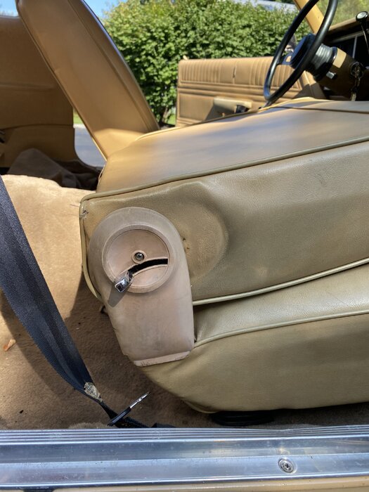

Bench seat?
look like this?
DCAspen
Sep 27, 2011
1,460
368
ct.
Sorry I don’t have any like that, I’m junking that seat and was hoping that was the piece you wanted

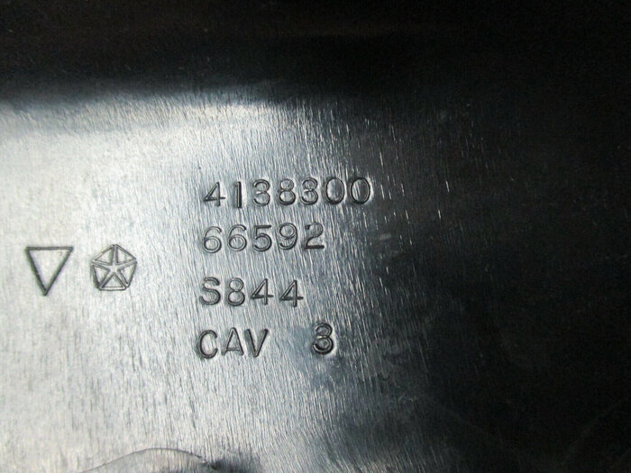

part number on either side for the hinge cover?
there should be one on the backside of it
Send me a PM on this
dodgeman316
Aug 22, 2022
26
8
These are the numbers on the back of the black one. 4138300. Would the part number be different for different colors?

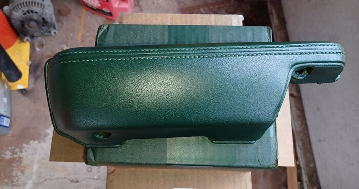

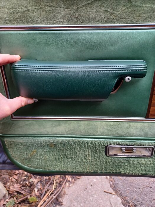

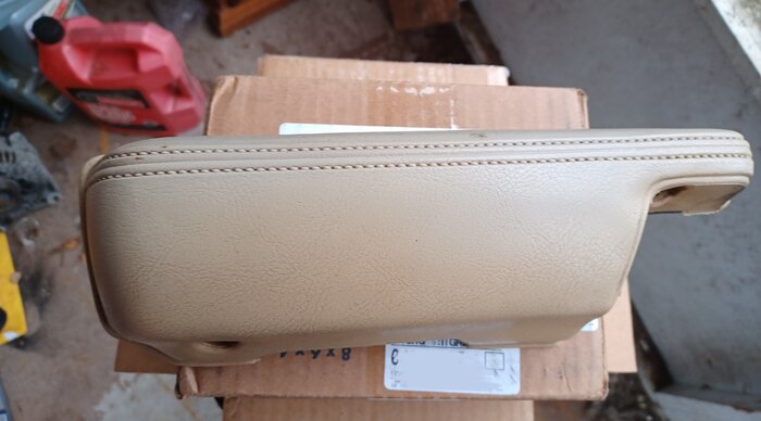

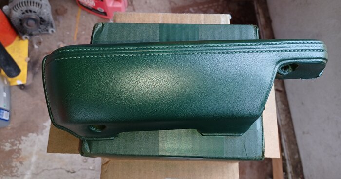

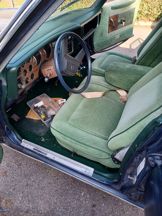

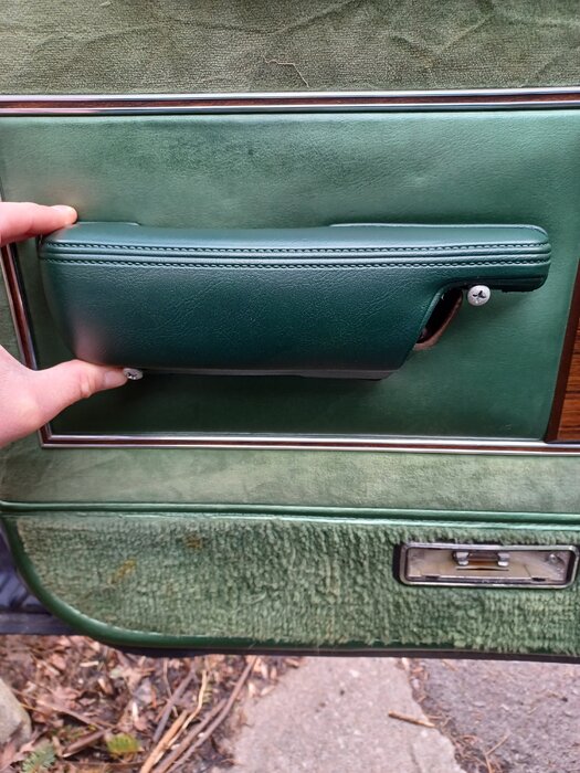

I used a green paint and the adhesion promoter to turn parts of my interior green to match the seats, door cards and carpet. It's not an an exact match. 20230406_143437.jpg
20230406_152034.jpg20230406_160502 (1).jpg20230414_164007.jpg20230406_163654.jpg
Herb's Parts: HERBS PARTS INTERIOR PAINT, Interior Paint, PAINT
Herb's Parts: ADHESION PROMOTER FOR INTERIOR PAINT, Interior Paint, 215(1)
basically you need some kind of adhesion promoter or plastic primer to allow whatever green paint you use to stick to the surface. And you'll need several coats of paint otherwise it'll just scratch right off really easy.

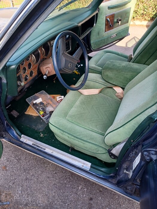

I painted my whole dash green months ago. Not one crack or blemish and it hasn't peeled.
I pulled all the plastic trim and painted it green too. The only problem I ran into was with heavily oxidized plastic that was extremely sun damaged. It takes a lot of paint to make it stay green and even then it looks like freshly painted junk. But, like you, I've had extreme difficulty sourcing plastic interior trim for these vehicles

I used a green paint and the adhesion promoter to turn parts of my interior green to match the seats, door cards and carpet. It's not an an exact match. View attachment 50659
View attachment 50660View attachment 50661View attachment 50663View attachment 50662
