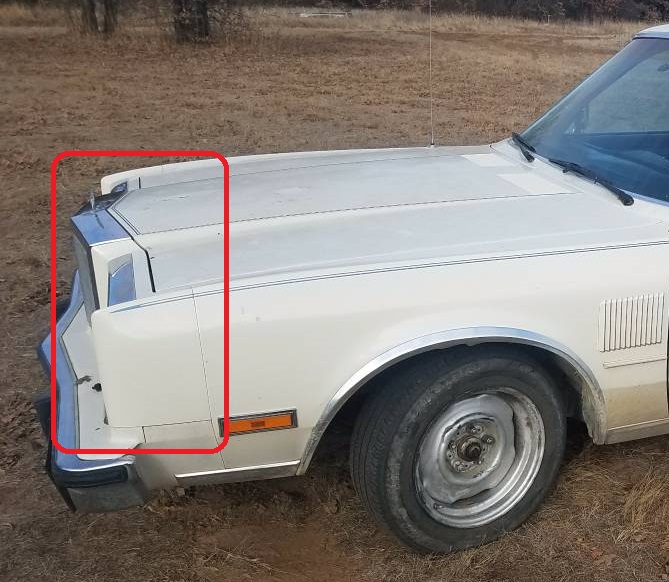

    If so, “I think” all M-body header panels will interchange – but there might be a difference on the hood on one version (so hood will need to be changed, as well) – again, “I think” (no first hand knowledge on trying to switch out with a different version header).
    I have removed and helped remove/installed the header on about 50 (or so) M-body’s before. It helps greatly to have a helper – especially on a header you are trying to save. Also, the metal studs that go through the fender are the tough part. The studs tend to spin in the fiberglass – which damages the fiberglass as well as stay attached to the nut making it very difficult to remove.
    I recommend soaking each of the through-fender stud nuts with rust penetrating oil a few times before attempting to remove those nuts. At one time I also modified a pair of smaller needle-hose vice-grips – making the thickness of the jaw thinner (via bench grinding) – so I could reach up behind the heater to grab ahold of the studs if they were starting to spin. The modified tool would only work on the lower studs, so it helped but not for all the studs.
    On the assembly line, M-bodies were painted with the header panel and the trunk extensions detached (separately) and attached to car later.

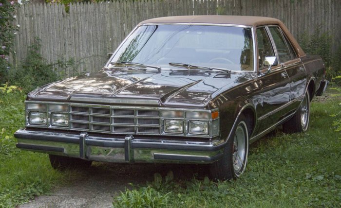

    1978 Lebaron

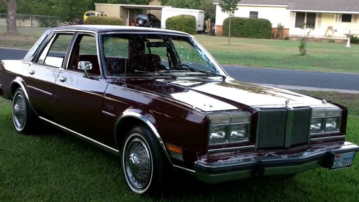

    1980 Lebaron

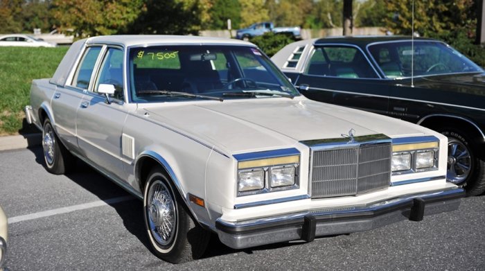

    1983 Fifth Ave

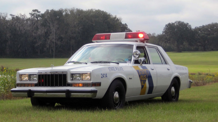

    1986 Diplomat

    I do like the 86 diplomat nose.
