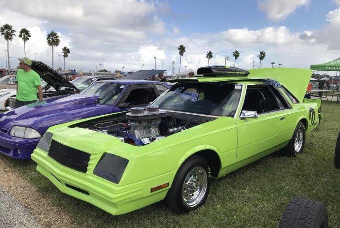

This car belongs to a member here, guys definitely like them and will spend money on the right one.
