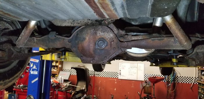

i appreciate the feedback. I will check and post the results. i'm going to pull it in the shop right now. maybe i can upload a photo.

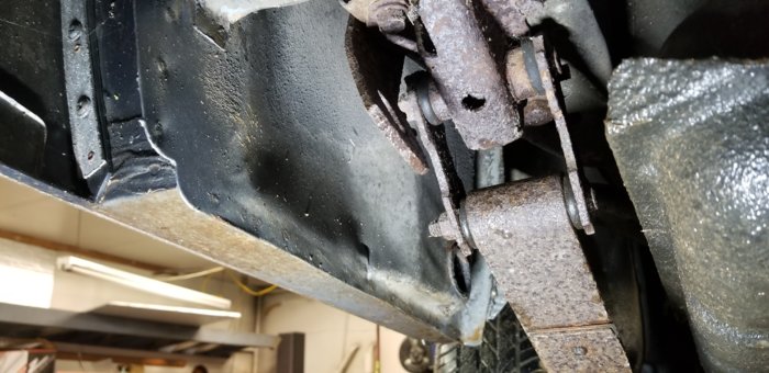

Looks like 7.25” and some worn shackle bushings, unfortunately.

Yeah that be a 7 1/4. 8 1/4 has the bigger tubes from end to end and doesn't have the flat sides on the housing cover.
