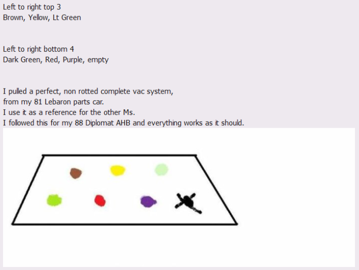

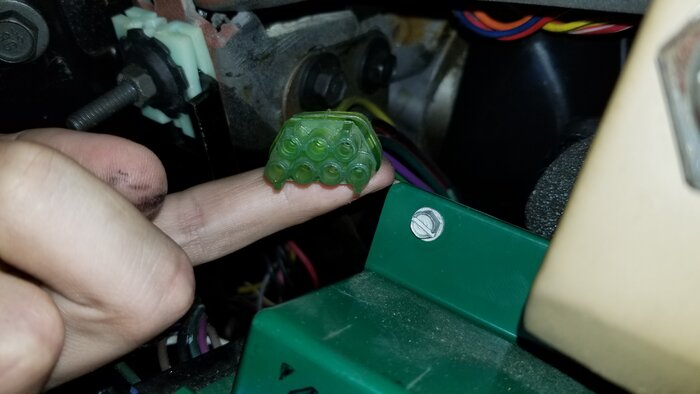

Hi all,
My under dash connector has deteriorated and I have lost vent/door control. I have six colored vac lines disconnected. These lines that go into a connector (ex. shown) from the head that are all black except one (red). Does anyone have the layout so I can reconnect them in the right spots?
Pic taken from @JBFury post
1,830
1,035
Had the same thing happen. I lopped the connector off and slipped new vacuum hose over top of the plastic line. Did one by one so I didn't mess the order.
