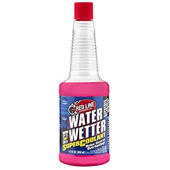

Adding a bottle of water wetter can do wonders for engine temps. It breaks the surface tension and allows better heat transfer to and (more importantly) from the coolant to the radiator tubes so the air can remove more heat.

Thanks for the reply. Yeah, the shroud is present. Not sure if there's an air dam present - I'll look. I'll try some Water Wetter too after a flush to see if that helps.

I was just listing things I've known to help the cooling system. I have seen the water wetter really help quite a bit.
