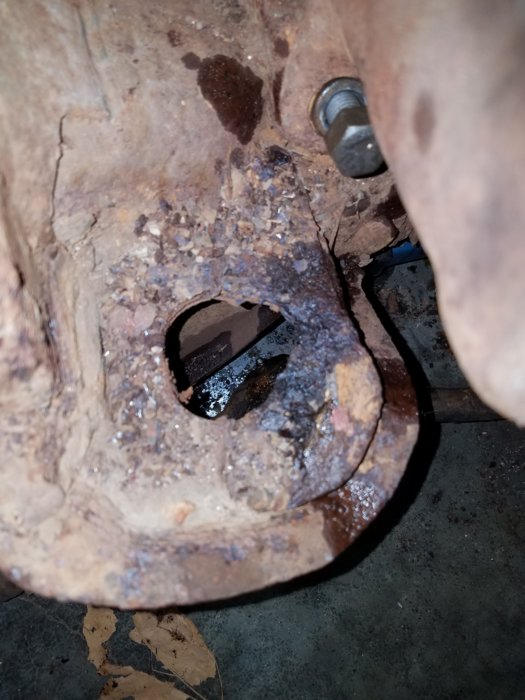

I have a question on my k frame. is this able to be saved? The hole is rusted pretty bad. also how do I remove the coupling from the steering box? My last one had a simple roll pin.
Yes I believe it can be repaired, what I would do with a K frame after removing from the body and removing all parts from it is to have it sandblasted. This will remove all rust and expose all cracks. Repairing rust is strait a forward repair if you have a welder or know someone who does.
