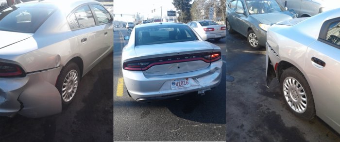

Speaking of body damage, I got tagged two days before Christmas by an older guy in a 2003 Mercury Sable wagon. It was ugly, but, the insurance company shelled out over $15,000 to make it right. I just got her back, good as new (mostly) Friday.

Well, just before the quarantine thing hit, I got her back again. Turned out the accident damaged the rear drive shaft and nobody caught that until I started driving the car. Car got towed back to the body shop then towed to the dealer for repair. All seems to be well now. I've even had the time to add the SRT rear spoiler. I'll say again however. Police cars are an acquired taste. If you get one, be ready to make a LOT of changes to make it livable as a daily driver.

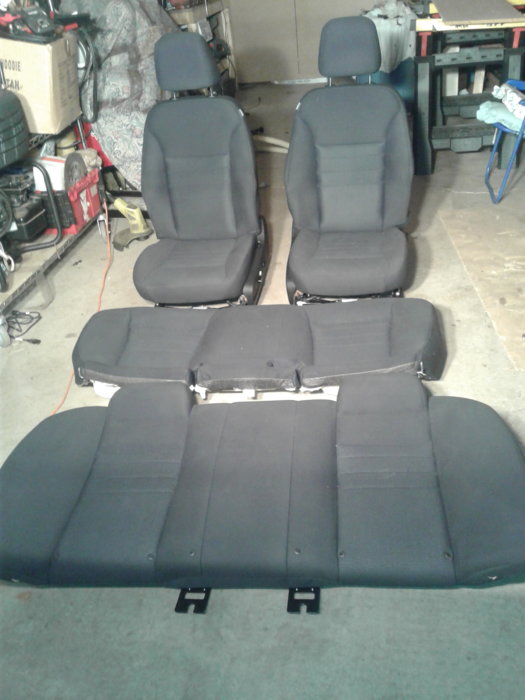

I'm working on getting the plastic one that these usually have. That should be good enough for selling it as long as the seatbelts are compatible and I'm sure they are. The next owner can worry about finding something more comfy unless it's some Wackenhut weirdo that wants to play police with it.

How about posting a pic or two and your story on the car. Cop cars lead hard lives. BTW, ANY 2015-2020 Charger or Chrysler 300 back seat will fit your rig.

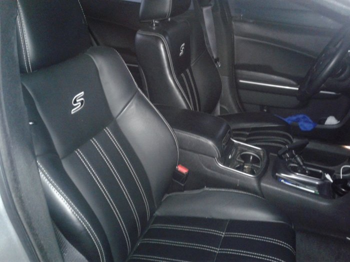

Were you able to get full power working on the 300 seats in your cop car? I tried and got everything working but I couldn't get the airbag light to go out on the dash. I wound up putting the leather 300 skins onto the Pursuit manual seat frames.

In my 2019, I got the interior front seats out of a 2015 300 and the rear out of a 2016 300. Both 300 front seats had full power and heating. The Pursuit had partial power on the drivers side and manual on the passengers side. The rear seats went in with no problem. The fronts didn't go so well. First time I put them in, the airbag light came on and stayed on. Figured out the seat belt clasp on the seat was depressed. It's designed to do that when the car is involved in a frontal impact. Once in that state, it causes the computer to fail the airbags if you put them into another car. Swapping on the clasp from the Pursuit didn't work because cop cars don't have that feature so the wiring wasn't the same. I DID have full power though. I also noticed that 300 power seats have two connectors underneath. One yellow and one grey. Cop cars only have the yellow one. Anyway, after all of that, taking the seats in and out and not getting the airbag light to go out, I just figured out it was easier to swap the leather skins off of the 300 power seat frames onto the Pursuit seat frames. It was actually easy and a straight swap. Worked out well.
I also got a console out of a 2015 Charger and added a $30 Sirius XM radio I got on CL. The carpet came out of a 300. Tell me about your radio/nav swap out? Did you use a junkyard unit and just plug it in?
