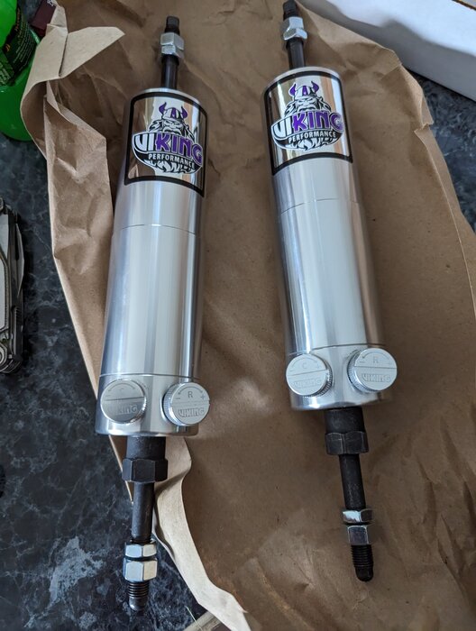

Shocks are here. 1.25" sway bar is about 8 weeks out.

Are those a special order? Tell us more about them, thanks.

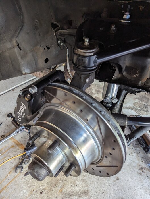

Passenger side is in. What a pain in the ass. Not the shocks fault.

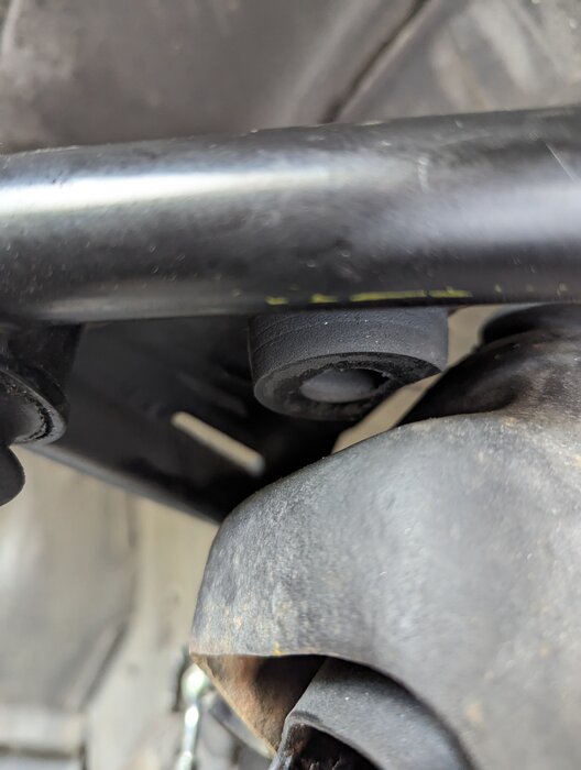

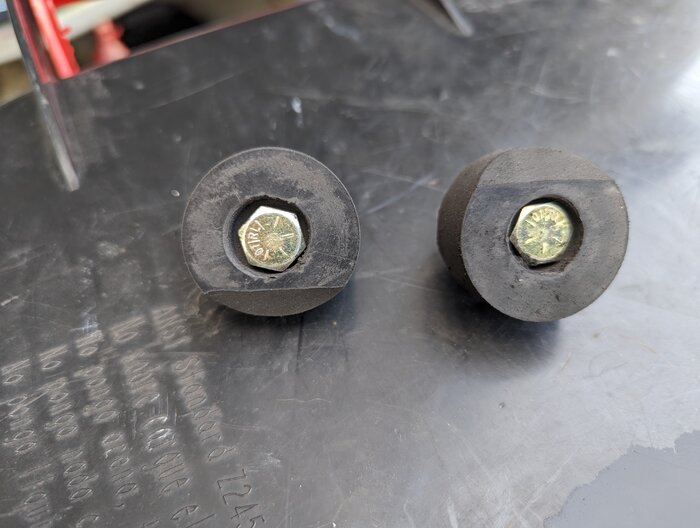

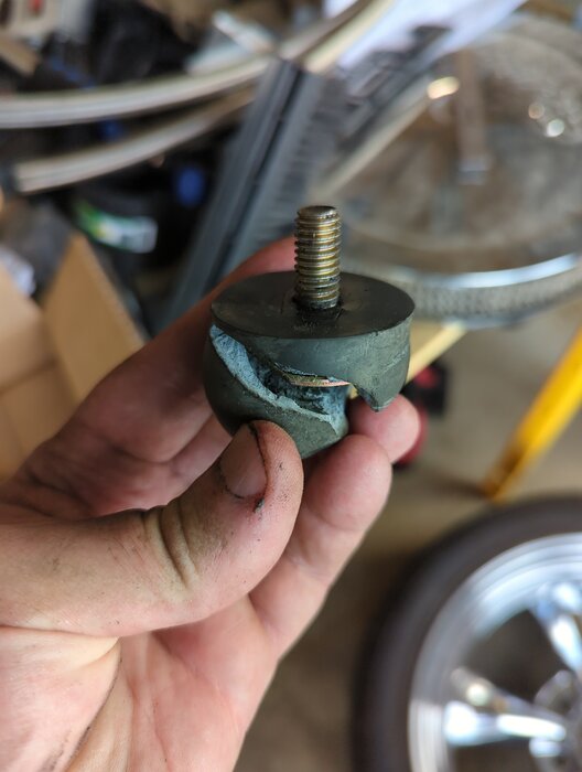

The FF upper arms bump stop placement was incorrect from design. Found them to be destroyed because of it after being in the car for ten years. My dad made me a new with the right fitment and I put them in at the dame time. These arms don't allow for enough downward travel to remove the shocks though. Didn't want to split the ball joints, so I pulled the lower control arm bolt and dropped that instead.
