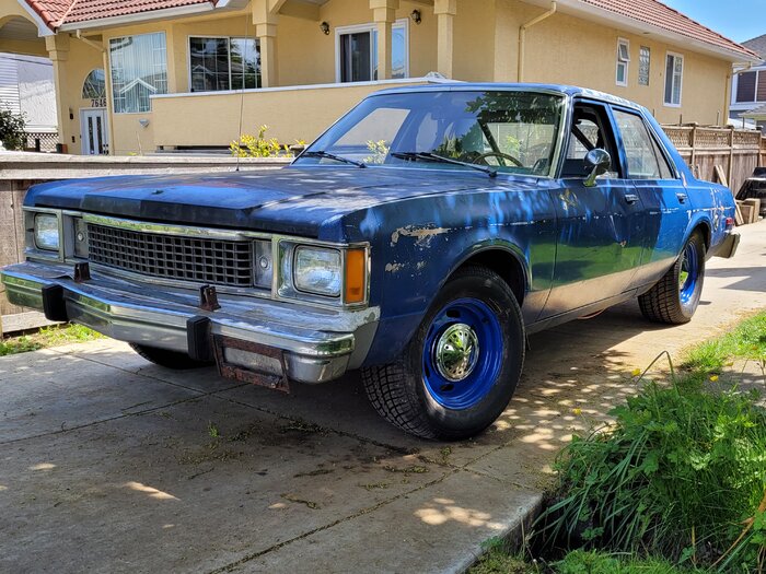

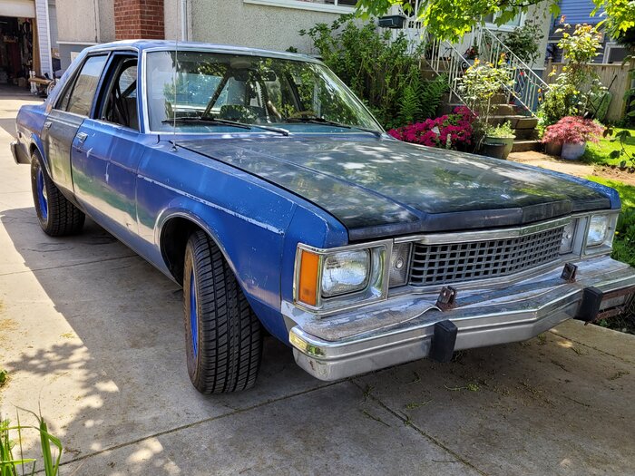

is this tire too small to work properly in a Volare?
245/60/15 fit better? or what about 255/60/15.
stock suspension, with the stock cop rally wheels

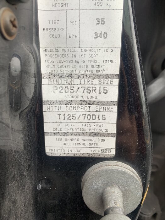

Factory tires were 205/75/15 on stock M bodies (27” x 8”) and what’s recommended as the minimum tire size for “standard load”.
Tire Size Comparison, here’s a nifty calculator with visual comparison of sizes.
As well, my factory door sticker.

thanks. i just want to put the largest tire that can fit, dont really care about sidewall/ratio/width.

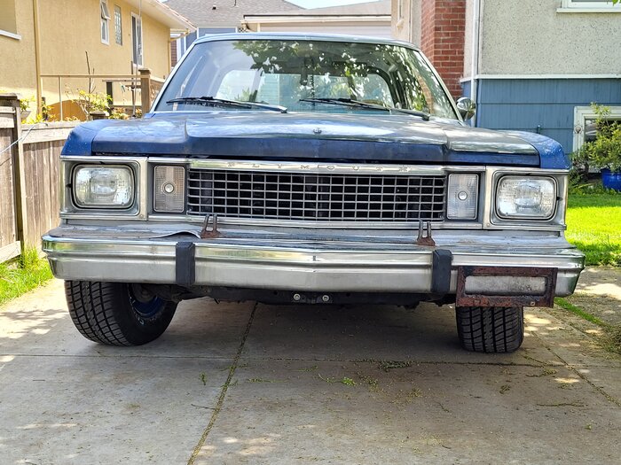

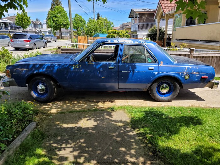

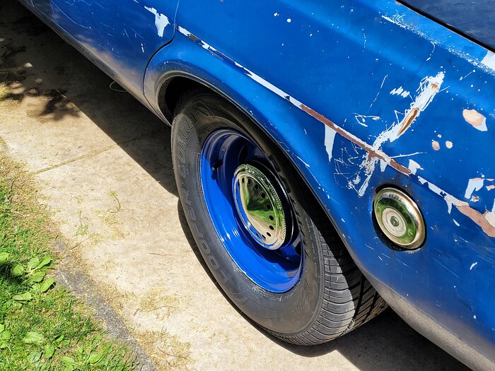

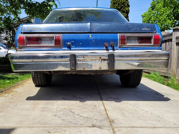

in case anyone is wondering/cares, 255 fit no issue on the front and 275/60r15 is the biggest that fit the rear with the 8.25 rear axle
