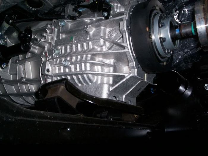

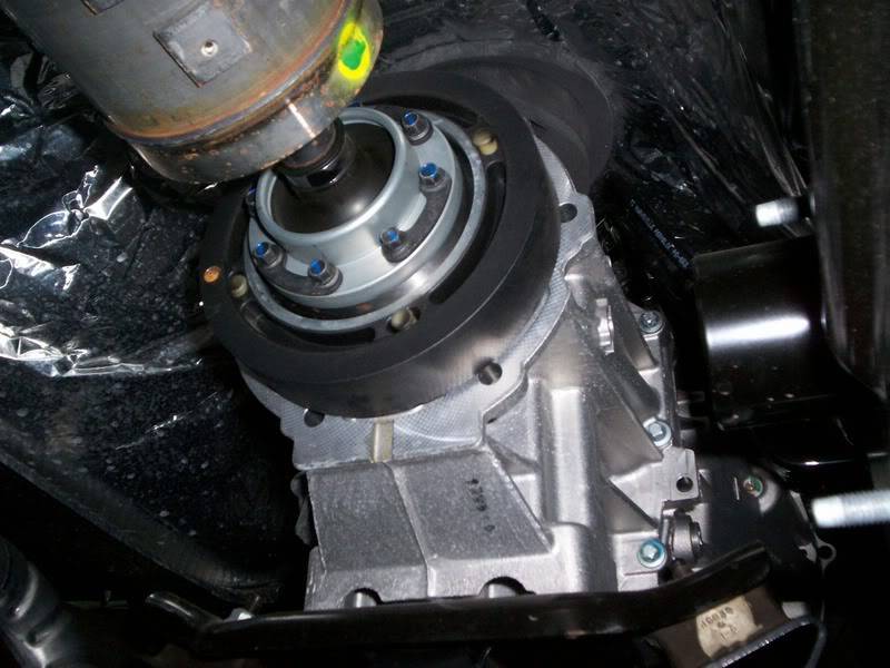

2WD tranny, driveshaft and for a 3.8. You'd have to source a 3.8 flywheel but I don't know if the flywheel for the 3.8 will work on the 3.5\4.0 but it's a start.
Back end looks like this:
Big fun, huh.
