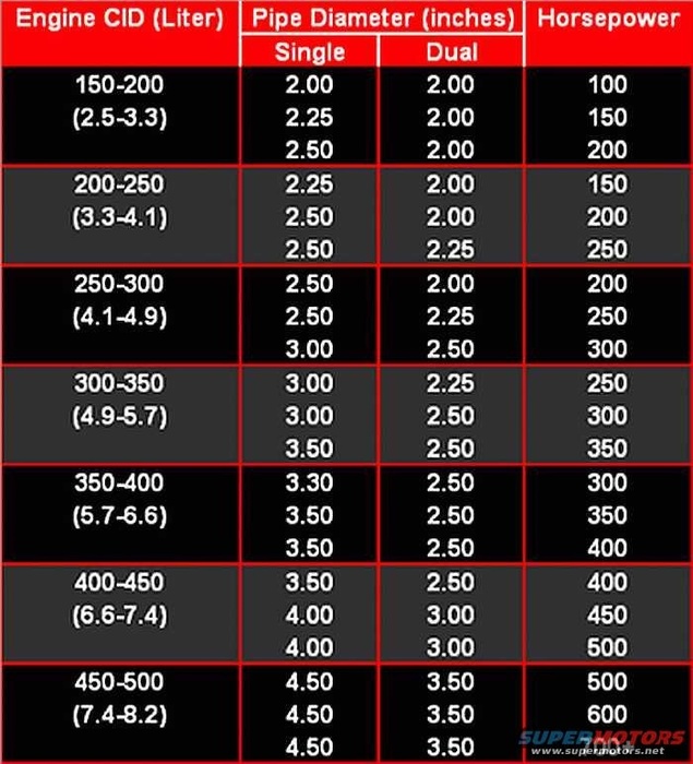

Here is a sizing chart I have found to be quite useful when running a full length muffled exhaust system......
As you can see, a dual 2-1/2" system starts becoming a flow restriction at around 400 HP and a dual 3" system starts becoming a flow restriction around 500 HP. Size accordingly and be sure to run a full sized crossover (balance) pipe connecting the left and right side exhaust wherever you can fit it behind collectors, but before muffler inlets. And don't sweat the hype about X-type crossovers. With a full length muffled system, an H-type crossover will work just as well. Even Dr. Gas (inventors of the X-type) on their web site mention that each engine/chassis/exhaust system is different and for many, an H-type works as well or better than the X-type.
If your engine will make over 400 HP, but you cannot fit 3" dual tail pipes...... Look at whether or not you could run twin pipes on each side (4 pipes in all). 2 pipes 2-1/2" in diameter will flow nearly as much as a single 3" pipe. If this will work for you, look at mufflers configured like a Suburban muffler (single 3" inlet with dual 2-1/2" outlets) and run one of these on each side.
