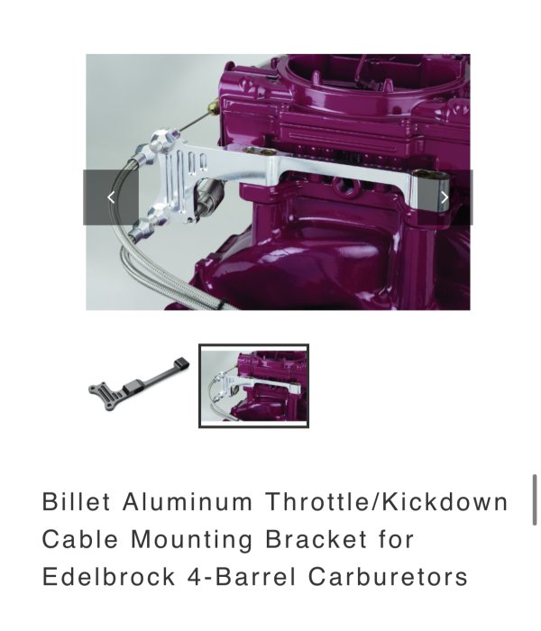

If I was to stay with the original throttle cable would something like this mount be what I am looking for?
Mancini Racing - Throttle Cable Bracket
If I use the Lokar setup for both the throttle and kickdown, I will also need to change the pedal
Using something like this?
https://www.lokar.com/assets/instructions/INS0002-ThrottleCable.pdf
Thanks for your help!
No, you don’t need to change the pedal to use a throttle cable from Lokar. Factory pedal works just fine.
The bracket you linked will work just fine, that’s their base bracket/return spring.
They also offer this billet mount cable mount for EdelBrock carbs- part #TCB-40DQ

Lokar kickdown, throttle cable and Edelbrock carb bracket ordered. Quite expensive…but most things are these days.
