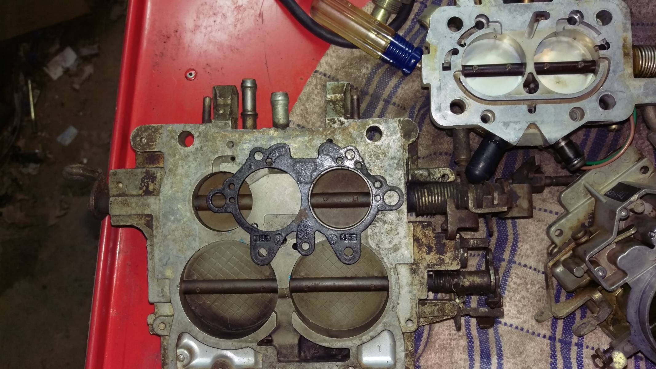

Rebuilding /cleaning/soaking my 2bbl figured as long as its apart it'd be nice to have a side by side comparison with a thermoquad for bore size. As you can see the primaries on this tq are actually a touch smaller than the 2bbl, and the secondaries... Cripes if that don't make a difference,.. I think the point about as long as you keep your foot out of it , you should be able to get as good, if not better mpg from the tq,
The car ran great and drove ok, but at the same time the car was a dog especially since i put the exhaust on. It kind of did what the tq did, it would punish you for laying into the throttle too much. Idle wise the car runs just as good if not better than with the lean burn, Throttle response and overall performance while driving the car is a major difference. I'm actually thinking about just putting a performance 2 bbl on it and calling it a day.
