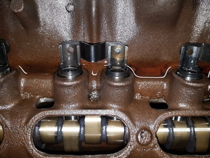

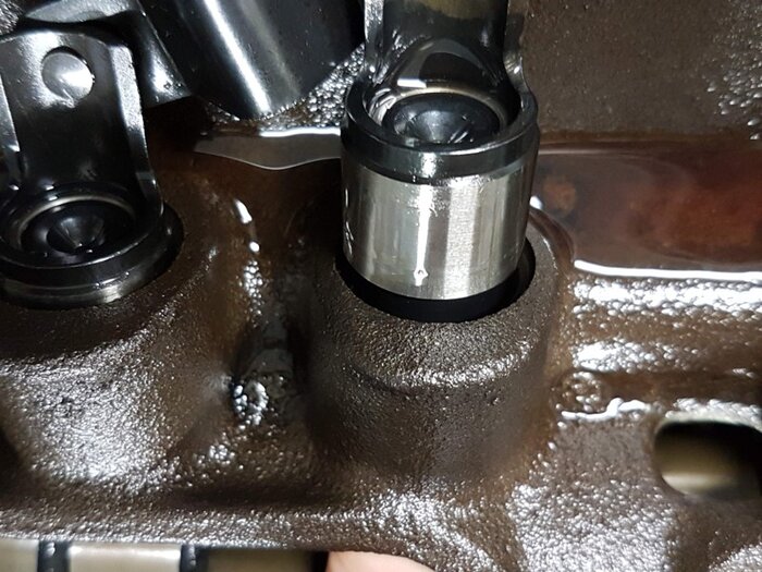

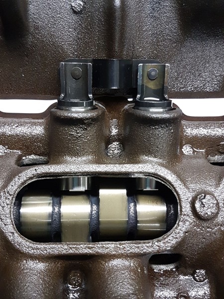

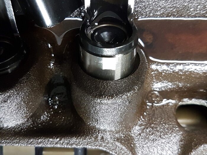

Here is what my non-roller block with the current CompCams 8920 roller lifters look like. I am showing you two key things here:
1) the placement of the lifter in my block at cam base circle and how far into the lifter bore the top of the lifter is
2) the placement of the lifter in my block at max lobe lift and how far OUT of the lifter bore the top fo the lifter is
3) the NOT desired placement with the oiling band exposed (this is over-emphasized, but if that band - the dark part of the lifter - is exposed, the oil pressure that feeds all the lifters just causes that oil to dump into the lifter valley)

Ohh...one more thing: the factory non-roller lifter bores that are most susceptible to this issue are those which show a deep chamfer of the lifter bore (so at the top), my block does not, in fact that was one of the things I looked for when shopping for the block.
Currently with my CompCams XR292HR cam, I am fine, but that's only a .365" lobe lift cam. I have a measured 0.200" room in my lifter bore before the lifter is out too far and the oiling band is exposed. For my purposes it is safe to say I will NEVER run a cam that big!!! LOL

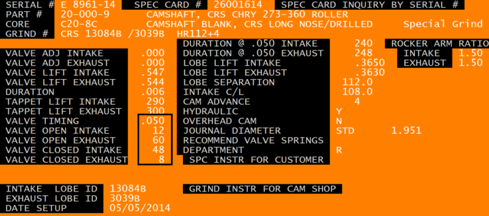

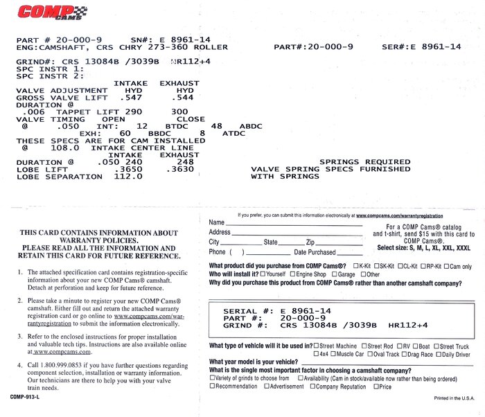

I've attached the XR292HR cam card as well as the detailed grind specs from CompCams.
