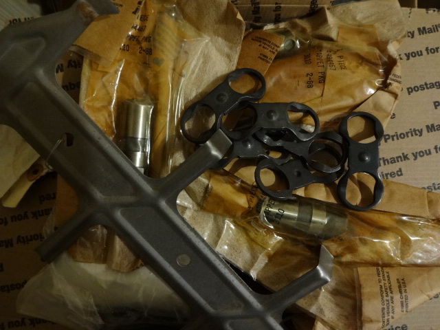

    parts for 1989 360 van motor --- for the factory roller lifters i need the pieces that keep the lifters from rotating and are held in place by thin metal bolt in pan thanks

    You need the spyder and dog bones, they are no longer sold by mopar so you need to go to the pic and pull or find one parting a semi low mile motor.

    thanks no one seems to have them

    got the spyder not the bones need 4 2 motors thanks

    the part number should be 4483045 Lambert shows 4 of them according to partsvoice.com Some are on ebay too. Apparently the V6 uses the same part number so maybe that would help your search.
