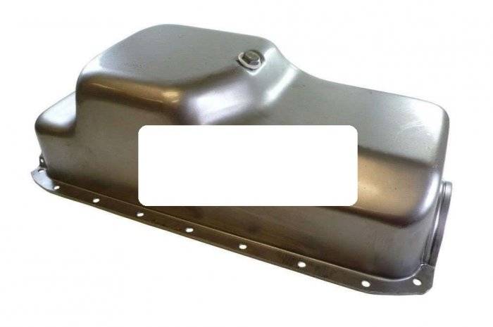

Engine oil pan. Just find any car (not truck) 360 (center sump) oil pan. The 318 oil pan will not come close to fitting. One like this one would work great Chrysler Mopar 1971-80 Hot Street Rat Rod Oil Pan Raw Steel 360 Center Sump SB | eBay
Note: you may already have a usable pan. Just make sure the sump looks like this (and not to either end).

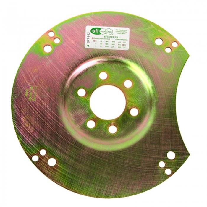

A “balanced” flexplate, so you can retain your existing torque converter (this is the best option, instead of replacing torque converter with one already balanced for 360 eng) B&M Automotive 10236 Flexplate FLEXPLATE MOPAR 360 W/TF727 TRANS.

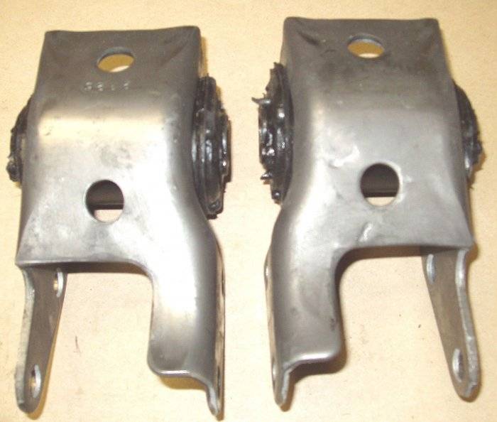

The right side engine mount is wider on 340 and 360 engines, by about ½ inch (13 mm) – going by memory. You can use longer bolts and washers to compensate for the difference but finding the correct right side mount would be better 73 74 75 76 DUSTER 318 340 360 ENGINE MOTOR MOUNTS "PAIR" | eBay

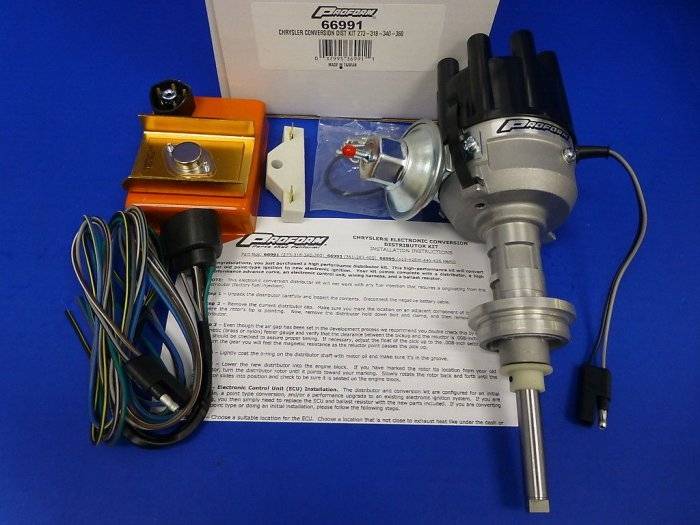

It appears you will need to find a 318 or 360 distributer (with vacuum advance) and ICM (Ignition Control Module). This (or one like it) should fix the ignition problem Proform Electronic Ignition Distributor Kit Mopar Dodge Chrysler 273 318 340 360 | eBay

If your existing 318 was Lean Burn - but no longer have the computer for it, then finding a non-computer controlled carburetor will also be on your list of things to get. There is a chance your 360 might also be computer controlled (will need to see a picture of it to tell).

Right side motor mounts are the same between 318 and 360. The left side mount for a 360/340 is narrower than a 318, but a 318 one will work.

Opps, aye, the 340/360 Left mount is narrower than a 318, not wider (my bad).
I have replaced with larger engine using correct mount as well as using longer bolts and washers (have employed both methods). I still recommend the correct mount for I have had the longer bolts/washers loosen on me before. It might not be a big deal, sense there are 3 bolts holding mount to engine, but it annoys me for some reason (not what you do, but what I do/have done).
