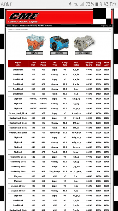

According to the video, there was already $6K in the 410 stroker. Using either a good used 360, or one that you own already have, with maybe just a basic good rebuild (~$2.5K), and new complete iron Magnum heads (valves, springs, retainers, locks and guides installed, ~$1K or so), you can come very close to beating the 410 in the video, perhaps even bettering its numbers with a well chosen cam and a good tune.
Sorry. Screen shot. A little blurry.
