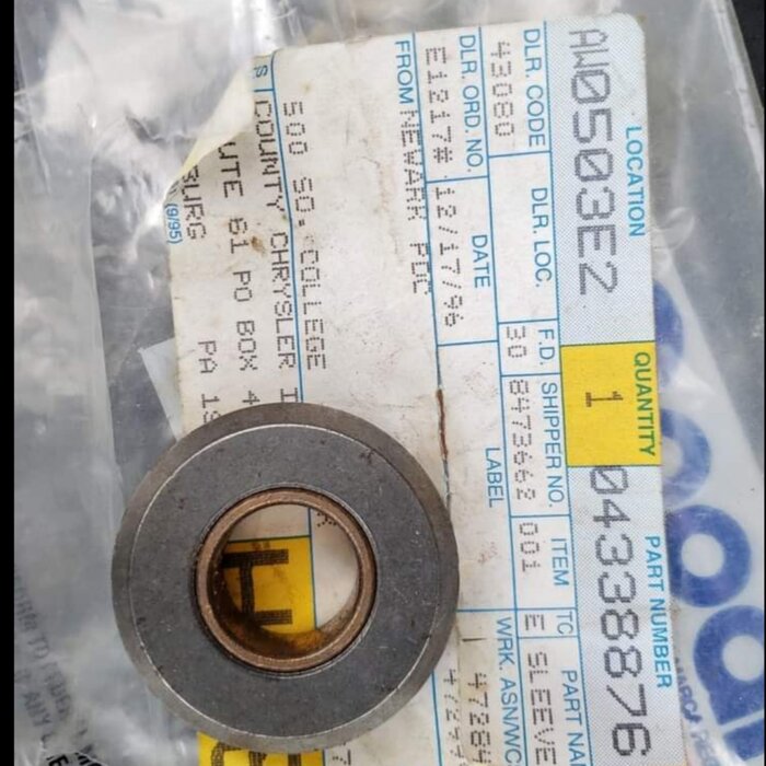

The input shaft can be shortened and a bushing which locates on the torque converter register can be used.
I used a bearing style like that on one of the Oldsmobile's I changed to a 4 speed in the past. This car had the bearing in it, but they didn't shorten the input shaft enough or at all. I would think you would have to know the transmission wasn't going in right with it like that or that would make noise, move with the clutch pedal depressed, or something that would raise a red flag. When I got it it sounded good. In case anybody is wondering getting a A833 out with a mushroomed input shaft is a nightmare.
