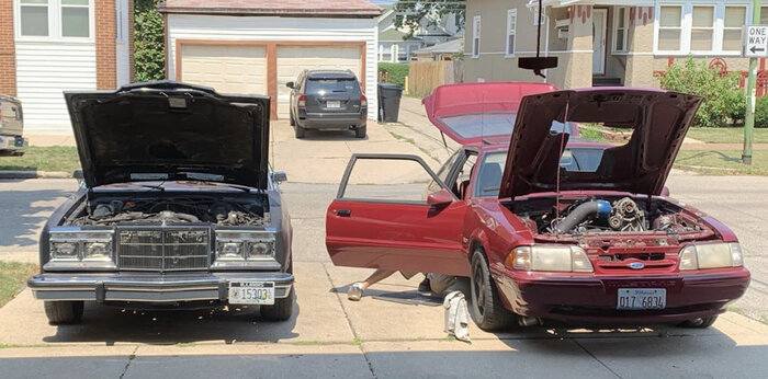

I need to do some reading. Could one of you help me obtain a pinout for the van (I hate going to my local dealership)? Me and my buddy cobbled shit together from a Silverado, gto and a gmc van to stick a 5.3 into his mustang and get it running down the road.

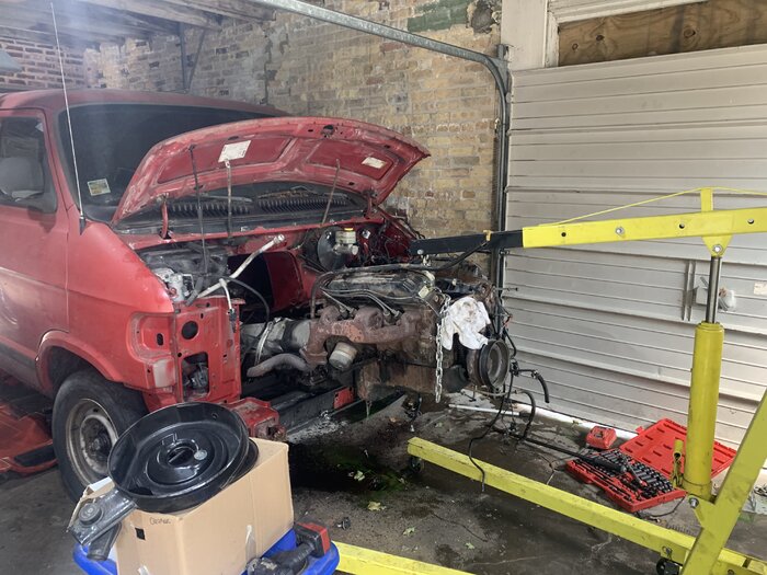

Spent the early afternoon in labor.
