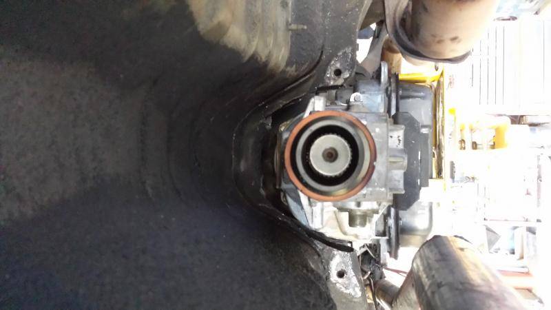

had to cut up crossmember and support to fit the 518 up high. linkage fit pretty well. ill take a pic of my scab crossmember when i put it back up in the air. i also did the grand cherokee disc brake conversion in the rear. i put a trac-loc and 3.55 gears in at the same time. pics to come.
